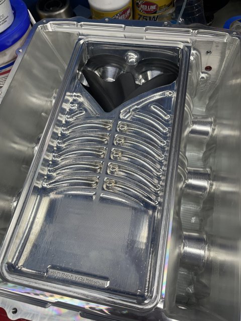

Whipple now coming out with a hellcat 3.8

Definately will NOT fit the Redeye stock hood. I do have an Anderson Composite CF raised hood I bought to fit the 3.8 dragpack that I was gonna use but now selling. Its brand new never installed sitting in box lol. Gonna put up for sale soon.
Thanks for the info Marc. Just waiting on Whipple to release pricing at this point.
Billet version looks really nice. Do you know if the 3.8 with the larger intercooler upgrade fits under a stock Redeye hood?
Thanks, I saw on one of the Hellcat racing facebook groups that there is one of the 3.8 cars running a carbon redeye hood I just wasn't sure what difference there is clearance wise from the stock version.
