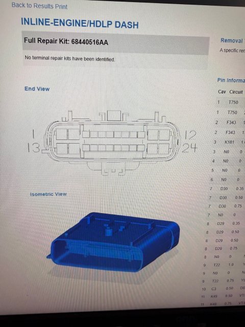

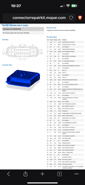

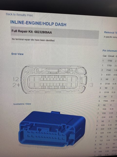

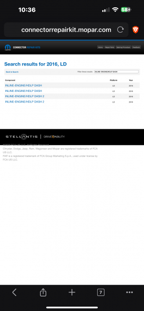

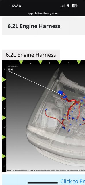

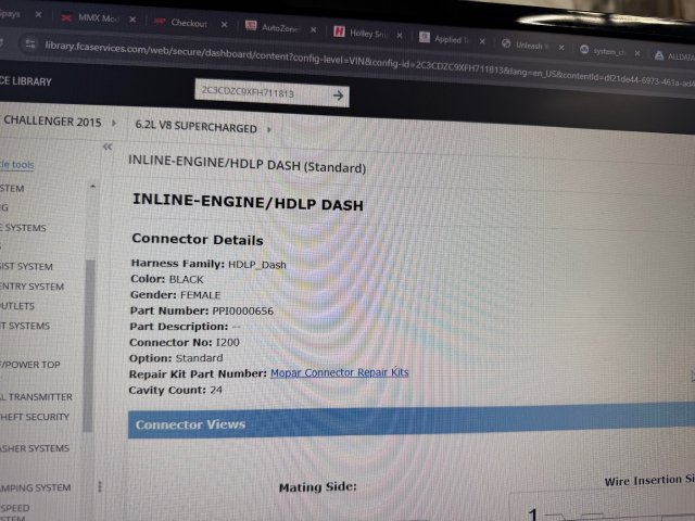

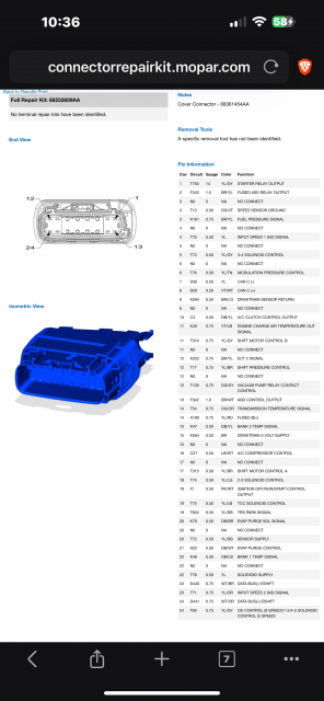

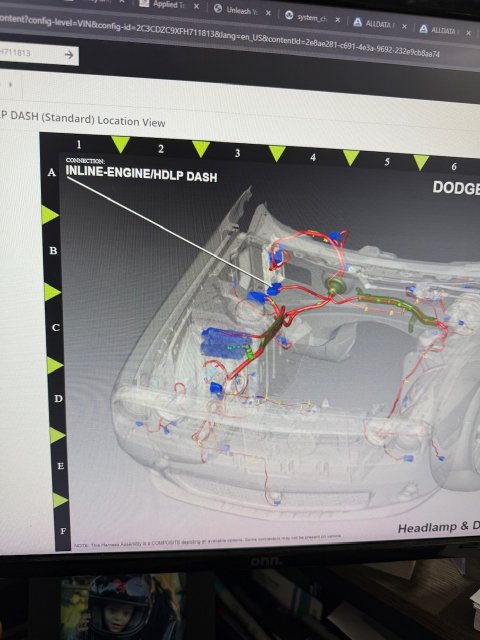

Anyway this is the inline engine/dash and headlamp connector. https://connectorrepairkit.mopar.com/ put year/make and search for “INLINE-ENGINE/HDLP DASH
so chilton gives you a wanker name
witech gives you the real name

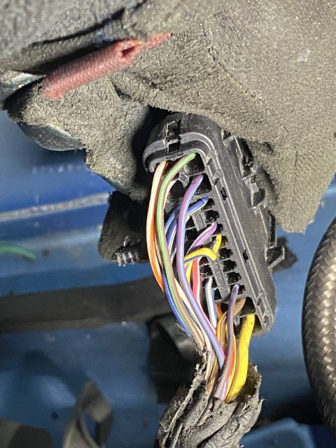

My main thing is why are mine different colors on one side and the other?

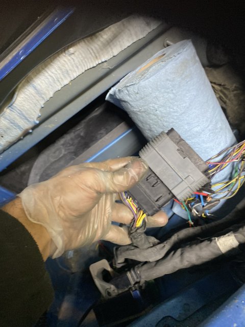

So I accidentally melted a piece to my harness connector and I didn’t take a photo and can’t for the life of me find a pin out for it. Also I can’t just put the same colors that are on my other side of the connector for some reason theu don’t match it the harness to the pcm but not c1 or c2 it’s actually a 24 cavity connector before those and it uses 18 of those pins going to attach pix but if anyone could just take a photo of theirs for me to get the color order thst would be amazing I don’t wanna burn up my unlocked PCM. The one that isn’t destroyed is has only 1 brown wire with yellow tracer however the opposite side has 3 brown with yellow tracer and I can’t get them in the correct order plz help
How'd you melt the connection?

I’ll pay pal you to send me that or is it on chilton? If I type same name of harness?
If you go to the URL i quoted, put in make and model youll get the info you need. IMG_5651.png IMG_5652.png IMG_5653.png
