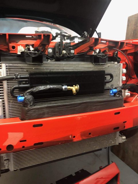

Ummm. I’ll just say this..... I didn’t cut the front bumper crash bar. Simply mounted the brick to the underside using the included brackets. I know... it blocks some of the lower radiator. Makes no difference. Driving the car around in 100++ degree heat in Phoenix with no rise in engine coolant temps. I know what the instructions say. Men never follow instructions. Ask my wife. 69514F96-7EC4-4125-973A-F31BC72A3FEA.jpeg

Ummm. I’ll just say this..... I didn’t cut the front bumper crash bar. Simply mounted the brick to the underside using the included brackets. I know... it blocks some of the lower radiator. Makes no difference. Driving the car around in 100++ degree heat in Phoenix with no rise in engine coolant temps. I know what the instructions say. Men never follow instructions. Ask my wife. View attachment 3939
Nice. This is a reply I can ponder on...
Thank you.

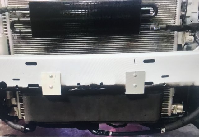

Our Active Interchiller 19" Competition Xtreme Chiller can be mounted by cutting only halfway through the crash bar and retaining one of the 2 boxes, this can not be seen and does not block any airflow. Or you could do our 13" Vertical Chiller that is very efficient and is 100% bolt-on under L headlight by removing the small aux. HX. We will be a Vendor on here as soon as its setup, so there will be full information. We will also have a Hellcat Demonstrate our 19" Interchiller at FL2k Sunday morning 10/13

FI Interchiller Stage 1 mounted on my car.
