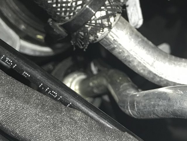

Hi @Lize I had trouble with my AC not working and it was from a failing T stat.
But you may have a problem like this guy had of the AC lines rubbing together, which causes a small leak of fluid.
This is some more info I found for you.

Thanks for the info, I'll try and have a look next week but got quite a lot on so will see how I go.
