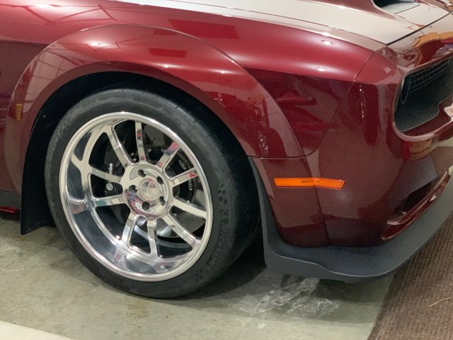

Okay, some people think some of us that run laps with these monsters are crazy. Thanks! I believe this will help us at least get the proper rubber to the pavement, AND BE FUNCTIONAL AND FIT UNDER THE BODY. The Widebody revision has made it possible without ANY wheel liner modifications. So we need to give the Dodge designers some thanks, even if some think the flairs look goofy. I say with enough rubber under them, the Widebody looks damn mean, and it is! We managed to tuck a lot of rubber under it.
So #797 has been working with Biz over @TRIUMPH The dude was stressing! He was sure enough he had the secret sauce to make one "trial", wheel with one of my new Michelin Cup 2 325/30's on it. I received it today, tried it and it looks great.
The Roadster design here in a two piece looks much like the design I had in a monoblock on my '15. Biz does quality work. I wanted chrome, but they needed to be durable, because this set is for the track. He had the wheels coated to protect them and will allow me to pressure wash and just soap the nasty brake dust that will cake them on a course.
My recommendation get a set of these, and if for the street, you would be mean with a 325-30F 345/30R staggered rubber. We shall see what they feel like for the course. The cat is also receiving lots of tightening up of its young joints in a procedure soon. More of that later. Here are some pictures. Things fit well, can't wait to get all four on and drive it!

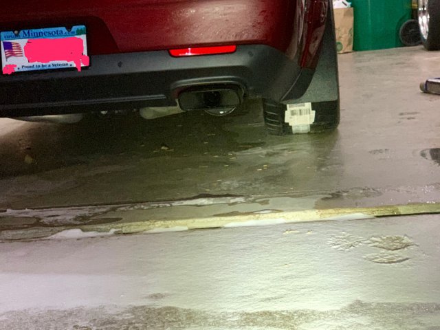

STUFF LOOKS JUST FINE OUT BACK! She could use more if a guy wanted, but then it would not be square. That is the point of this. Sorry it's winter, that is about all we have for now!

Love seeing the checkered flag on those tires... that car means business! Looks great.

Looks great, I like chrome also but I sure like what Biz has done. John
7000 Posts Club
7,435
47,194
Quality and attention to details! When we get the other three and it is outside, I'll give everyone a closer look. My surprise was he welded the backside of the center and I don't have to worry about cleaning around 60 bolt heads. Being in the industrial/infrastructure business, I have looked at my share of welds. The welds on this wheel look as good as about any human can perform. The coating he talked me into on the barrel will make it also easy to clean the brake dust and other nastiness off that lapping one of these beasts produces.

Wheels look great! Unfrortunately, being poor folk, I doubt I'll ever see a widebody charger. So you're saying with no mods to well you think you could get 345 in there?

Thanks @Magnified, I got 345's on my street set already, it can take more! Front is a different story, there is a limit to what will reasonably work up there. Unless a guy is a puss and don't really drive it right. The Widebody has a generous space in the rear totally unmodified. Don't even need to pin the rear of the liner like we did with the regular body. What happened is after looking at that wheel/325 on the back, it looked rather skinny! Sorry, what a pig a guy can become quick. Plus when looking at the 325 on 12" VS the 345 on 12" in my garage, there was not much difference. So.... the 345 is just a bit taller which helps a little problem we have at Brainerd with the top of 6th gear and what the hell, "go big or go home" saying, Biz and I decided I would order up a pair of big ones for the rears. They should be in during the next week. Discount Tire Direct needed to order some fresh units up from Michelin. Plus they gave me a good deal compared to the folks who actually have them in stock. Damn it at over $500 each, I'll take more help. Maybe once they come in, the driveway will be dry and I can snap some real pictures of the queen.

Beautiful! Look at the lip on that front wheel!
