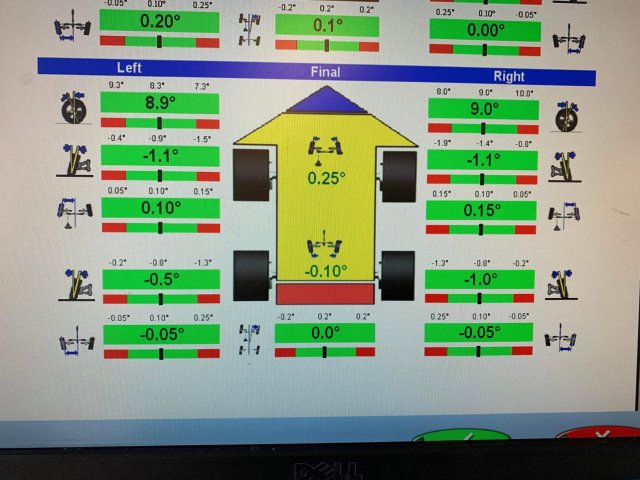

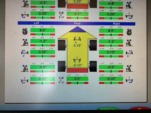

I forgot I am a little positive camber in the rear. I'm not sure if toe was adjusted or not
