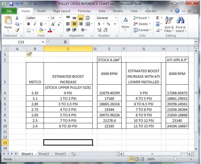

Does anyone have the chart or math that shows how much boost is expected with a 2.57 pulley, or how I can calculate it for a 2.4 supercharger?
Found this in my notes:

What's this chart showing then? Rotor rpm is way higher.
Also my 2.86 upper stock lower has shown a 4-5# increase over stock on a 2.4..

@Unholy707 that chart was accurate for my 2.72 pulley, but boost doesn't really matter it's aircharge that counts.
@Octanewide the pulley chart is drive ratio for the supercharger pulley. The chart you posted is male rotor RPM which is a not to exceed critical speed.

The male rotor spins 66% faster than the female.
The stock Nachi 6203 bearing holding the rotor in the front bearing plate is only rated for a 12k RPM limiting speed, which is why upgrading that bearing is rather important if you're going to push it to even higher RPM than stock.
Also, there will be a critical speed for the rotor itself--beyond which can be a different set of problems--of a much more exciting variety...
