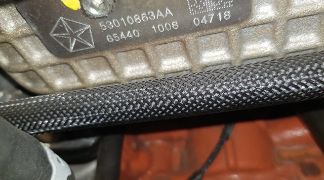

So with all that out of the way, my advise is look at your SC# part number. It should be located at the rear of the SC by the firewall. (Image below)

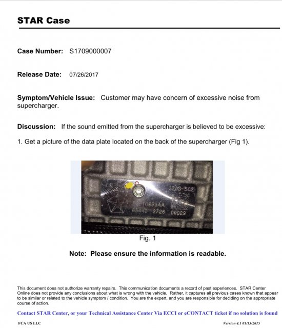

If you have anything ending AA-AF I'd be concerned. Also please note that I ended my research into all of this mid 2017. So a lot has probably changed since then. Also the only STAR Case info that was available at this time seems to have vanished. Here is how that use to read at the time. (Image)
So in closing, if you are hearing something out of the norm...chances are your ears are not deceiving you. If you have a 2015-2017 with an IHI SC part number ending in AA-AF I'd be even more concerned. What you choose to do with this info in entirely up to you however. Good luck!

Now you have me curious what mine is but being on the back of it guess you can't see on the car

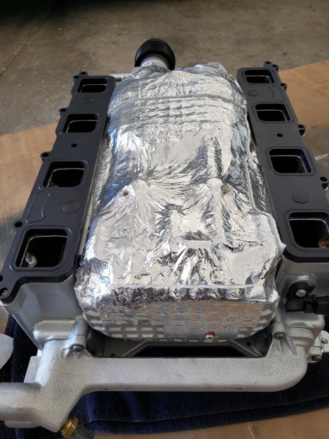

Dug through my pics when I had the blower off putting the spacers on and was able to blow up the pic on my phone, it appears to be AF 20200613_125341.jpg

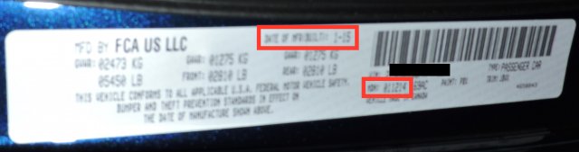

you'll find your build date and hour on a tag on the drivers side door, VIN has no relationship to the build date, just the model year
example:
top center is the date of manufacture {when completed, not when started], in this case finished in Jan 2015
below the barcode, you'll find an MDH [month, day, hour], in this case Jan 12 1400hrs
