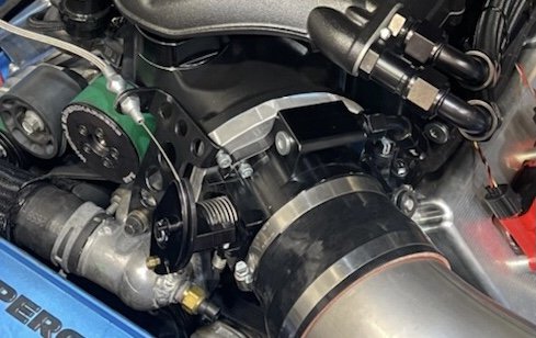

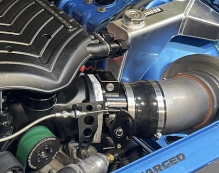

We decided at the last minute before Houston to replace the 3.0 with my 3.8. This was on the 401 in the blue car that was making 1200whp thru the TH400. Some limiting factors…. Just swapped over the 108 tb off the 3.0. We will be running a new 120 when it’s put together in mine. Also went conservative on the pulley with a 3.125. We immediately saw 29 lbs and 1400 whp. You be the judge 🤓

No Tb no fuel fittings no air intake system
Need to buy adapter to for tb. And fittings

We fabricated all that. C19E263E-ADA1-4C17-96E3-65BC21698F53.jpeg 239129CE-6F77-4CA4-85DF-5BE608913C38.jpeg
