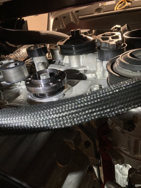

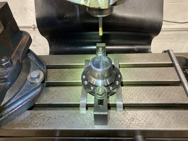

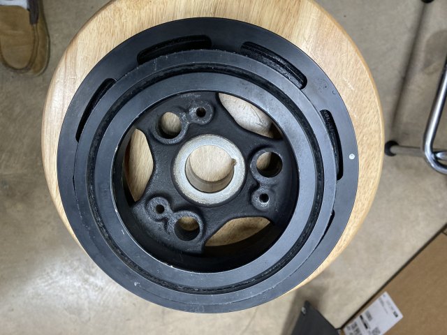

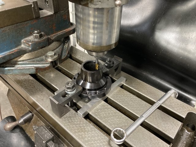

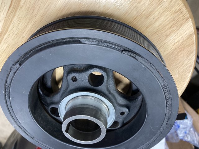

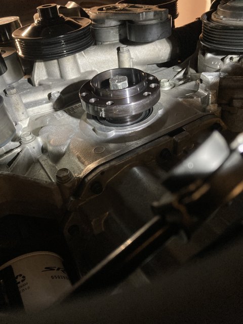

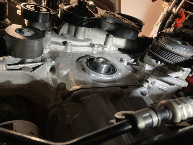

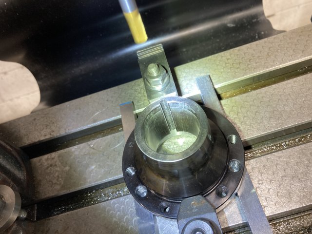

When I was stock I pinned my crank using this kit: https://highhorseperformance.com/hh...or-15-current-gen-iii-hemi-supercharged-6-2l/, to prevent my crank head from looking like swiss cheese can I re-use the key hole? Has anyone encountered this before? I'm thinking I can use the kit and overlay it over the key hole and drill that and then re-insert the pin. Good idea/bad idea?
