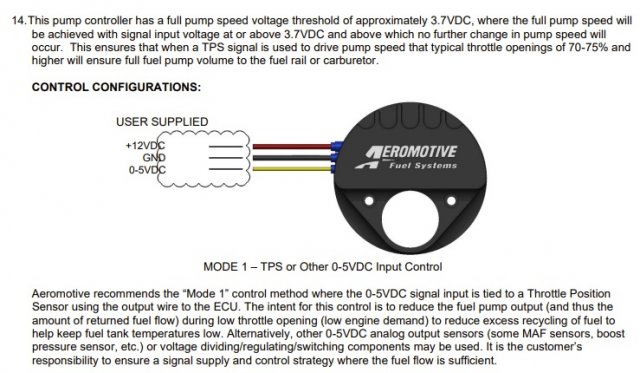

I have to start thinking about fuel system soon. I was looking at the Aeromotive 5.0 brushless fuel pump. The pump is located here: https://aeromotiveinc.com/product/b...spur-gear-pump-with-variable-speed-controller. It's a variable speed controller but the PWM from the FPCM cannot be used, that is on a scale of 0-12v (theory, no real data in the FSM or online to support this). However Aeromotive says that a voltage source from 0-5V would be perfectly acceptable.
What sources would be acceptable for 0-5v? Hellcrate doesn't want you touching the harness on the throttle body (I am assuming a dirty signal condition). What alternatives are there that won't create a dirty signal condition? Or do I scrap all this and just put the relay on a 12v switch and have it going 100% all the time, it's a race car so I don't need to worry about it being on 24/7.
