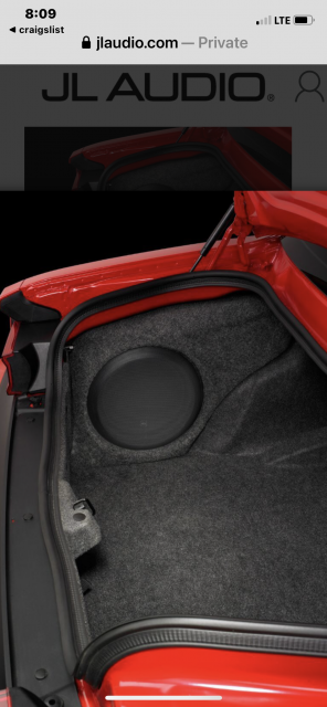

Just like the title reads, anyone have any experience with this subwoofer? I bought the Performance Spare Tire kit, but still have the factory subs in the tire well and keep trying to find some subs custom fit to the car, so I can mount the spare where it belongs. Any opinions? 7DF586D4-D243-480B-9B02-89389B094B73.jpeg 0B7FC7DB-97B3-40A6-9B4E-EBF11F0658F7.png

I think maybe if you have the Alpine it may be a step up but looking at that - it looks really shallow. I dont know that it would actually be a step up from the HK.

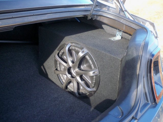

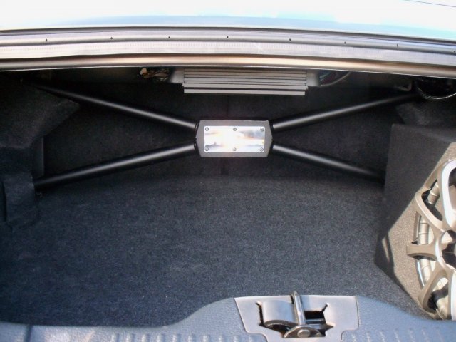

I found a box made to fit my last Mustang and put in a 10" Kicker. So there may be more options
I understand what you mean, regarding the sound of the two 10” HK subs (which I have in the car now) vs the single 12” JL Audio sub, which also requires a separate amp. However, my objective is to get a spare tire in the well now occupied by the HK subs. If I lose a little bass doing that, I can live with it. I bought a spare tire kit, but hate having it bouncing around, loose in the trunk and taking up a bunch of room. Besides, I have horrible hearing already, I’ll probably never know the difference!

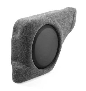

I'm going to try one. Is the 'box' plastic or fiberglass?
They’re fiberglass, I believe. I bought one locally for sale on Craigslist. Looks good, well made. Fairly heavy for its size. I haven’t had it installed (along with a new 500 watt JL amp) yet. Next week.

Before I try the Stealthbox, I am going to price a custom box that fits in the same space made of 3/4" MDF, glued, braced and covered with a material that matches the trunk.
My biggest issue with the Stealthbox is the PRICE. I understand JL Audio stuff is good stuff, but the specific driver in the Stealthbox (13TW5v2-2) is not one of their top shelve drivers. This driver is around $310. So the box is $460. That's outrageous.
The driver I want to use is the 13TW5v2. Either a 2 or 4 ohm, doesn't matter. I will just get whatever amp is necessary. The 2 ohm is hard to find. This is a much higher quality woofer that actually needs less space in the box. The Stealthbox is 1.25 cu ft. The driver I want to use only needs .8 cu ft.
