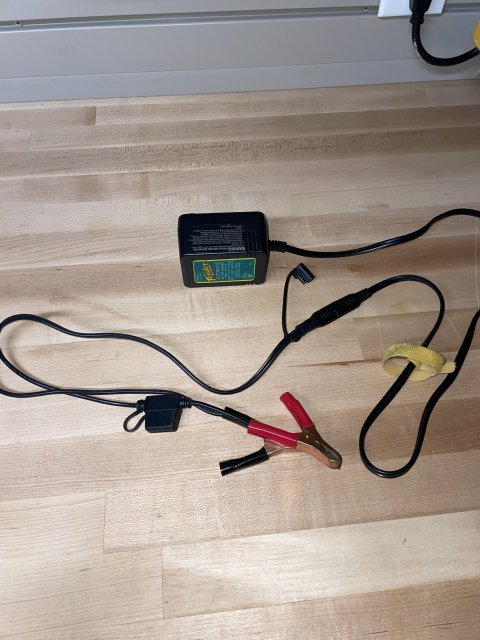

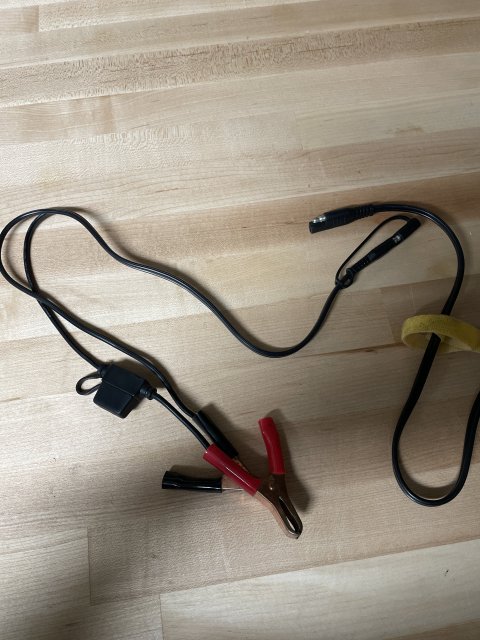

My battery tender has a disconnect in the wires. I guess you can leave the wire connected to the battery or posts under the hood and just disconnect the battery tender from the pigtail? It’s long enough that the hood can be closed and the connector can be left sticking out. It has a plug to cap the exposed end image.jpg image.jpg
