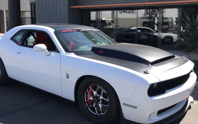

I put about 500 miles on the 18” Winlites with M/T Sportsman tires under normal around town and freeway miles. No issues. They drive, steer and stop nice. The Winlite is a superior wheel. 0D076FFF-2E7A-4E6C-8797-B6F6F0AB0228.jpeg

You are the type of responder I was hoping for. Good news or bad, it's always good to learn from other peoples' similar experiences. Thanks for letting me know you've had good luck with this setup.

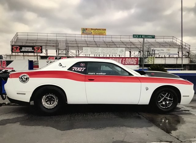

Hi Glen. Thanks for offering! I have a DragPak rear suspension (4-link) in my Hellcat. I’m using your Comp series double beadlocks with a 4” back space with 315/60-15 M/T’s. I’m thinking about running a “small tire” class that will require going to a 275 radial. Question is…. What width wheel to get the most out of that tire ? There are small tire class cars running as wide as 14” to stretch the tire. I’ve had some people tell me that’s not safe. Others simply say everybody’s doing it and it works. What are your thoughts on that? Also…. Those Comp 7 wheels are the most beautiful wheels out there. I’ve looked at a lot of wheels and nothing compares. I went from your Winlites to those when we stepped up to our current setup. Thanks!

Beautiful Car! I see many people using a 14” wide it’s safe and works. I think the 13” wheel is a little more forgiving with sidewall not being as stretched. 12” is the old standard by todays racers. It’s more of a personal preference and how you the racer feel honestly. I recommend the 13” wide to those on the fence lol.
