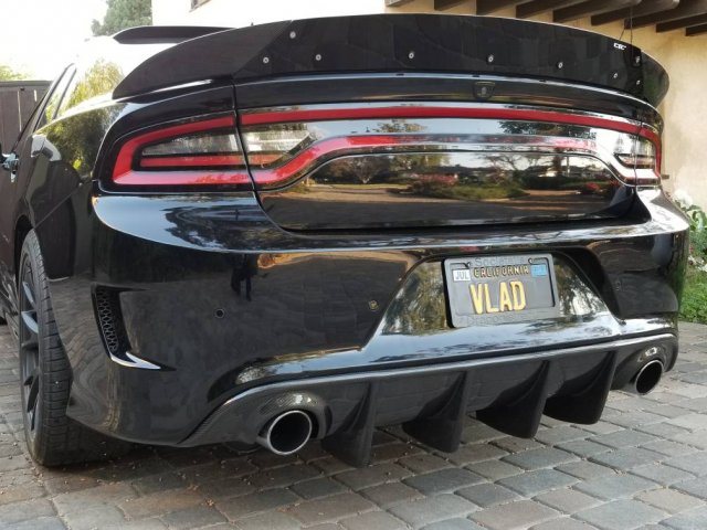

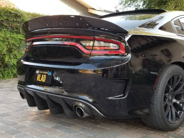

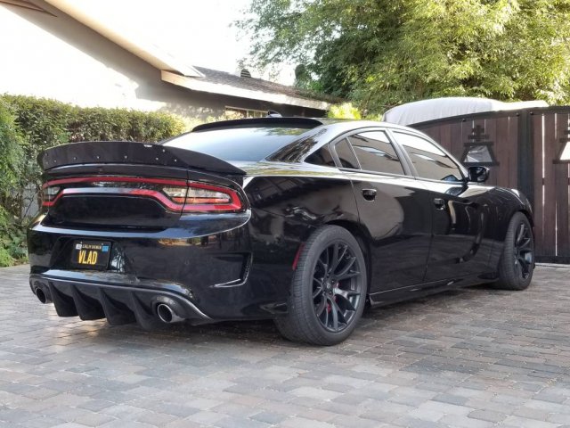

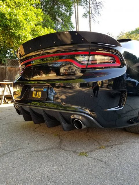

Just a few more pix, for those on the hunt for some carbon fiber accessories :)
