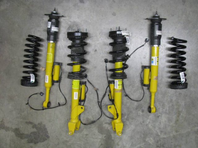

I did a little poking around the differential yesterday, took some measurements and came up with a few ideas to tighten things up. But, that's for later.
In the meantime I did some digging into the Adaptive Damping Suspension (ADS) in these cars. I started looking for a standalone system that would use the Bilstein shocks and allow the independent control of the rebound and compression functions. Unfortunately there isn't anything publicly available on Bilsteins' website (even doing a little backdoor tactics).
So here's what they gave us - note the leads to the tops and bottoms of the remote cylinder, those are the (electromagnetic(?)) adjustment for the valving. For reference Bilstein typically uses a monotube design for their shocks, which typically limits the amount you can lower a car and maintain functionality.
http://wk2jeeps.com/wk2_active_suspension.htm said:
The ADS shock assemblies are similar to conventional shock absorbers with the addition of a shock solenoid assembly and the associated wiring mounted to the shock absorber body. Please note that because the shock absorber is a monotube design, it is important to never support the shock by its tubular housing.
While some ADS components look similar to standard components, it is important to remember that these parts should not be interchanged.
So what is ADS and how does it work? Well per FCA ADS offers an assortment of modes.
https://www.fcapresskit.ca/2013/contents/Press-Releases/05_SRT/Challenger-SRT8-392/CN_2013_SRT_ChallengerSRT8-392_OV.pdf said:
Outstanding ride, handling and capability
New for 2013 is an improved Adaptive Damping Suspension (ADS) system that is expanded to three modes and tuned specifically for the Dodge Challenger SRT8 to provide an everyday performance ride or a much firmer race track-capable damping for more challenging driving situations.
In “Auto” (we now know this as Street) mode, a wide range of on-road and driver inputs –such as vehicle speed, steering angle, steering speed, brake torque, throttle position and longitudinal/lateral/vertical accelerations –automatically tune the suspension for specific conditions.
In “Sport” mode, the damping system rebound and compression is locked to a higher damping rate. Drivers can easily choose between settings with a press of a button on the centre stack to quickly change the shock damping characteristics from “Auto” for everyday commuting to “Sport” for more spirited driving situations.
In “Track” mode, the higher damping rates combine with a performance shifting and gear holding feature that allows the driver full shift control when using the steering wheel mounted paddle controls or Auto/Stick™.
The ADS system on the Dodge Challenger SRT8 392 features the fastest turn-in and most nimble handling characteristics of any SRT product. In the “Sport” or “Track” settings, the system provides the highest damping rates, allowing the driver to push the handling envelope to the extreme.
2018 Brochure said:
SRT-tuned Three-mode Adaptive Damping Suspension (ADS)
Street Mode = sporty, compliant ride
Sport Mode = firm, improved handling
Track Mode = firmest, maximum handling (SRT 392 and SRT Hellcat
Great for a standard road car, and quite likely the reason why folks default to "Street" mode for drag racing in a normal Hellcat or Redeye. But, what about the Demon?
https://www.hotrod.com/articles/demons-drag-mode-makes-faster/ said:
The Bilstein Adaptive Damping suspension adjusts the front and rear compression and rebound to optimize weight transfer onto the rear tires, softening front rebound while firming rear compression.
To prevent wheelhop, the launch control targets the wheel speed sensors to detect the driveline oscillations before they ruin the first 60 feet (maintaining full throttle, but cutting spark or fuel as necessary)
Firming up the rear compression, eh? Sounds familiar. Looking a little deeper we find that it boils down to the 90/10 and 50/50 in the Drag mode suspension setting.
2018 Brochure said:
SRT Demon-tuned Three-mode ADS Suspension
Auto (Street) mode = compliant ride (Compression/rebound -front & rear: soft/soft)
Sport mode = sporty ride and improved handling (front & rear: soft/firm)
Drag mode = maximum weight transfer (front: firm/soft & rear: firm/firm)
Another interesting note is that Demon uses four unique shocks (which are available through Rockauto at $600 each - LOL):
68316053AA - Rear Left
68316054AA - Rear Right
68316052AA - Front Left
68316051AA - Front Right
Meaning that it may not be a simple software change. May not. Or it may be but only within the design limitations of the standard HC/RE ADS shocks. But, again (as above) simply swapping part A for part B or changing some flags in the BCM may not be sufficient or effective, or at least as effective as an all Demon suspension swap.
For your additional reading pleasure I've added some files on the ADS shocks that I found from a 2015 thread on the other site. From what I have seen these cars don't react poorly to having the shocks disconnected, trouble codes - sure, but they can be swapped out. So, if that's the case than there is a potential to disconnect from the control module and manually manipulate the settings (assuming they are indeed 12v electromotors).

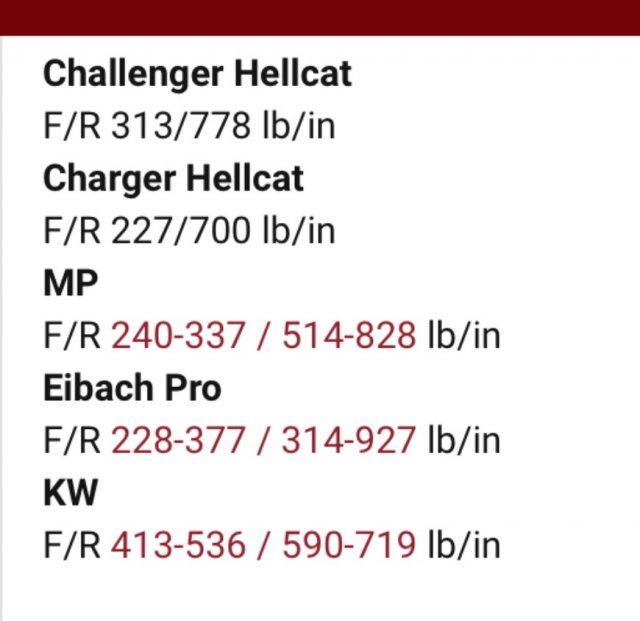

The linear rear spring rate of 778 lbs/in on the HC is the most stiff of the Mopar family.
Progressive rates available that are better ONLY on full compression are:
MP 514-828
Eibach Pro 314-927
Up front where the weight of the car is, the HC is soft at 313.
KW shines above the rest here with their progressive rate of 413-536.;)
MP 514-828
Eibach Pro 314-927
Indeed - chart attached for reference.
But, its about how the energy is managed. And until we can start adjusting our shocks independent of the stock parameters we are stuck testing other methods. A 50/50 bias in the rear makes the spring behave in a very neutral fashion which is great for a Demon - in the instance of using a HC/RE (as delivered) in Street mode we have to consider that the potential compression is going to be significantly softer than a Demon in Drag mode. Which means that locking out the rear and preventing squat is a reasonable objective, while leaving the front loose. It is a mechanical lock-out procedure for a suspension with very little room for adjustment to begin with - a simple case of fucking with the cock you got, not the cock you want.

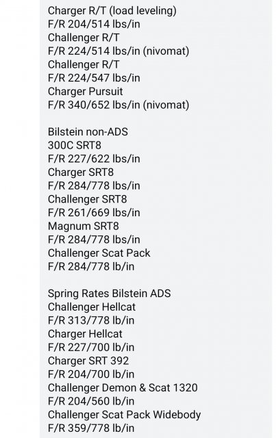

To supplement your thread, here are the aftermarket spring rates. IMG_1227.jpg

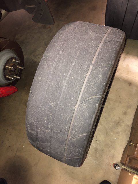

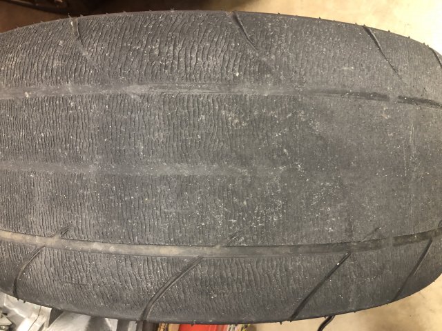

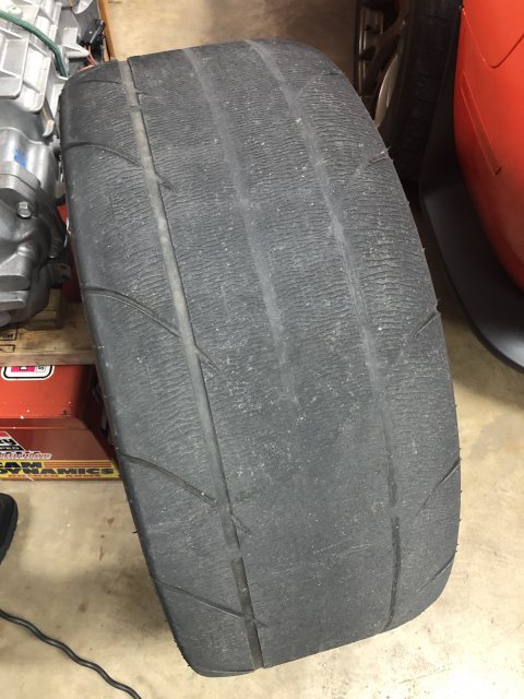

This some of the reason these tires looked like this after this days “practice” lol? Not worn evenly across?
95AFE868-BF24-4077-8E1D-7ACEF9D6CC0E.jpeg 4DE22747-3F32-45A8-904C-7A1AD9C512EC.jpeg DE1A7B9E-7870-416D-AF8F-38CB8A23ED4E.jpeg

I would imagine so. Possibly your toe setting a bit too. But mostly camber gain when it squats, exacerbated if the car is lowered. Why pay for the whole tire if you are only going use 3/4 of it?
The gentlemen who is going to set my car up and I had an in depth talk today. They are working on it this week. Does anyone know if taking the camber to one degree more than spec negative without any other adjustments will change the toe? Regardless we are going to see what happens if all four need -1 more, since I have the full set of AAD adjustable arms front and back.
If that is the inside of that tire, what does the other side look like? What did the track look like?
