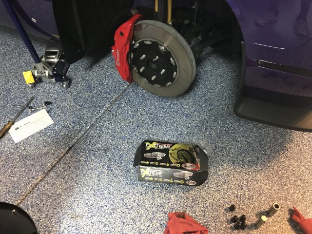

After only 300 miles I could not take the dust anymore. Yes all 4 corners. 8EE334A0-9938-49D4-AE90-1A0B2D1966A5.jpeg

I swapped all 4 out around the same time but honestly I’m thinking about switching back. Not impressed after a few hard stops at speed. And I bedded them in properly. Definitely not as fade resistant as the Brembo pads.

I could not take the dust and performance is about the same IMVHO. I did the same for my 2015 and have never regretted it.

The Powerstops require HEAVY bedding, not only heavier than what the box asks for, but also at least twice.
It goes without saying, take great care when doing this, allowing for the possibility of significant brake AND fluid fade during the bedding process. Again, take great care of others and yourself if you do this. No other cars or obstacles in your way as well as more safety margin than you need.
You will have MUCH better performance from them.

Just got all the Z26 pads installed yesterday, and of course it decided to rain today so I still need to do the "bedding" procedure.
Just like everyone said, it took way longer to get the car jacked up, clean up the caliper and wheels than it took to install the pads. I got an extra set of hardware for my front pads in the box...not sure why - guess it was a mistake from Powerstop since pins and spring plates in both packs were identical. The instruction sheet they provide isn't for Brembo style calipers at all...
When I took the OEM brake pads out, the only lube I saw on anything was a light film on the back of each brake pad, so I used the provided silicon lube by Powerstop and did the same prior to installing the Z26's. Everything else was bone dry...all the pins and plates.
The OEM Bembo pads still looked like new after I removed them, so I marked each set as to which caliper they were in and put them on the shelf.

Just got done testing it out with the new pads. I did some fairly hard stops speeding up to 30 then down to 5 without fully stopping with 30 second breaks in between. Did that around 12 times along with a couple of hard stops from 50 to 10 or so. No speaks, creeks or anything weird.
My opinion is these Z26's aren't nearly as "grabby" as the Brembos, but I think it makes the brakes seem more predictable on the street because of it. Of course, for a road course the Brembos would be the better choice, but I don't road race ...so I think I'll be fine with these.
