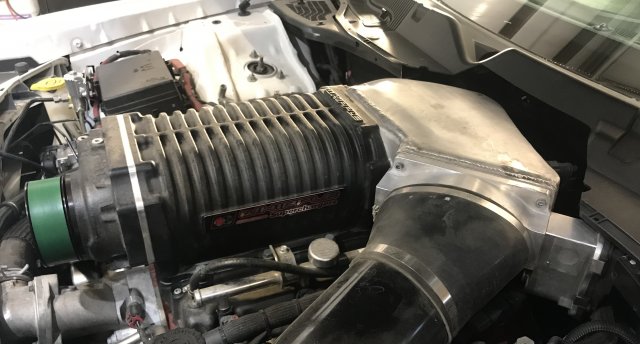

Spacer to increase plenum volume and some minor tweaking to the intake and they work great. 😝 BA23463E-8F1E-4018-BA9A-F2D4C2968F52.jpeg

Spacer to increase plenum volume and some minor tweaking to the intake and they work great. 😝 View attachment 105849
I wanted to do this to mine for the rear plenum, saw it on a green challenger hellcat years ago
5,533
4,567
Shouldn’t have to modify a $7k blower/throttle body though

I used 1/4” spacers on my front k member to drop it engine down low enough for 4.5 to clear hood with FI spacers, only way I got manifold #2 to seal. Still had to remove the flame retardant on the hood and notch part of it by the driver side washer hose. My wiper arm is still bent from original install lol
5,533
4,567
I still have the spacers, makes changing plugs a bit easier because it drops the passenger side out of the way of the PDC wires/plastic shroud covering them on passenger side strut tower. Was going to take them off but they level the rake of the car out which in my mind says is better for weight transfer but who knows
