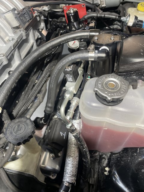

Semi buttoned up. New an lines on driver side. Spent 48 hours thrashing, wouldn't have it any other way. Time for bed, gonna do the coolant side during the week.

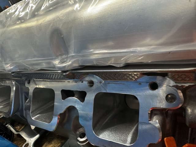

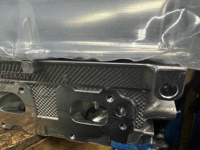

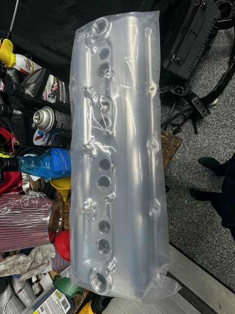

I had to modify my new Cornerstone covers to work with the power steering. I haven't seen any kits to eliminate the power steering on a hellcat yet.
Robert, What portion specifically had to be modified? I have the Cornerstone covers but no plans to have HHP install them until the new block is finalized.
Any pics of what had to be changed?
RGPIII
#983
1,016
1,887
Bridgeville
the front edge needs to be milled down pretty significantly. I've got the 6.1 pump and remote reservoir ordered.
