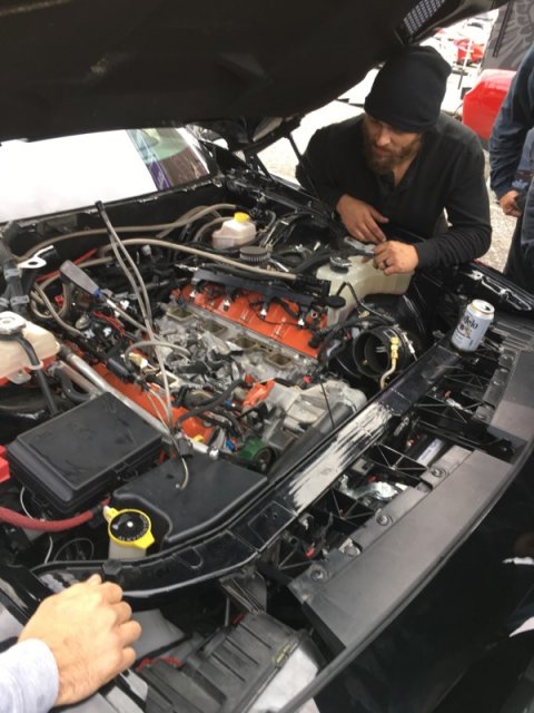

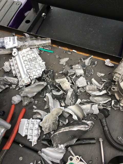

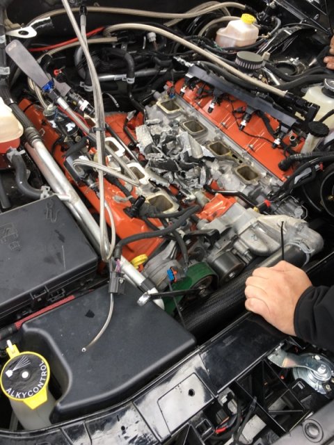

Here are a couple of pics from a Nitros Express user. This is what happens when forgetting to turn the NOS OFF during a burnout!

Of course it is.....that's just a few pics there are more times!
