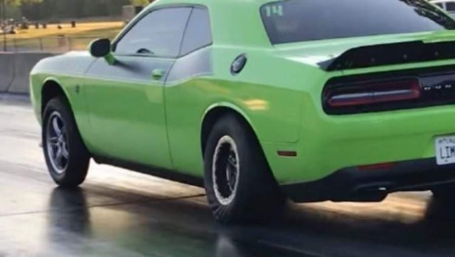

Hey I just spoke with Chris sawyer he was racing tonight and he has bmr arms and they broke and caused him to nearly hit the wall , unfortunately I will not be able to resale these arms knowing that they may risk breaking and possibly getting someone injured or possibly killed , i appreciate your interest but I will just throw them away

Thread Starter #31
Here’s a pic he sent me of the left rear wheel mid track
do you know which BMR arm failed? i just installed a set of bmr lower trailing arms (single adjustable) on a Scatpack

Thread Starter #35
He said both upper control arms
But I talked to jon Sipple and he did say on his car one of the lower trailing arms failed
