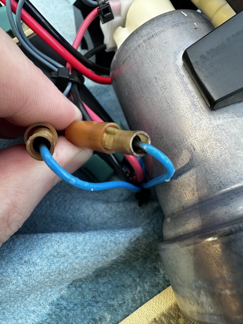

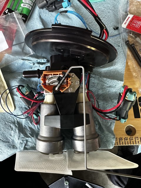

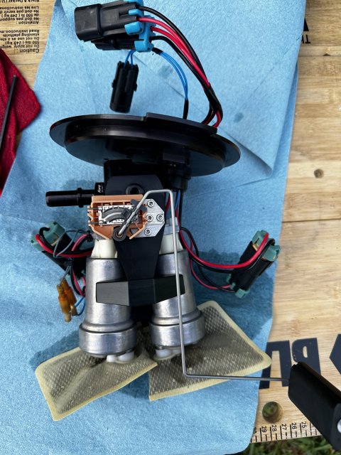

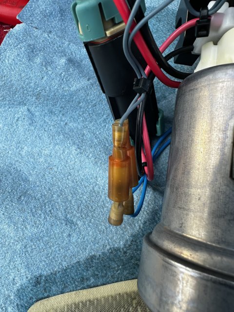

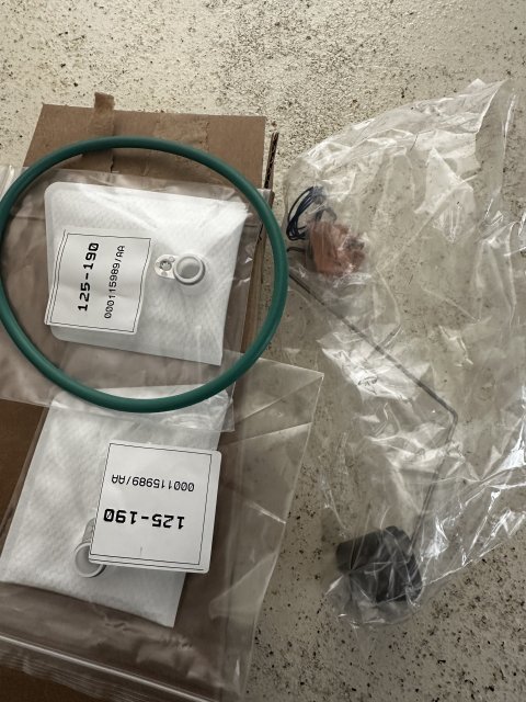

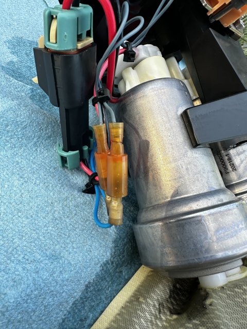

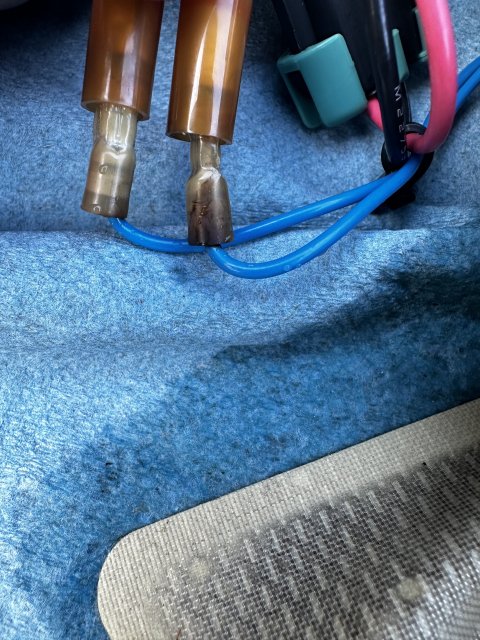

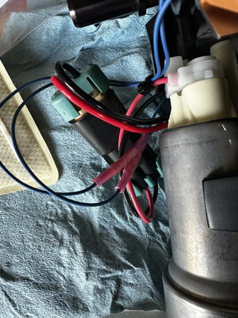

Weekend project. Waiting for a clear day in the driveway. Fuel light flashes intermittently when fuel gets near 1/4 tank and goes out. Scanned BCM and I’m getting a fuel level sensor short. Time to pull the dual pumps and change it out along with the filters. Might just be hung up on the wires for the pumps, but don’t think that would cause a short
