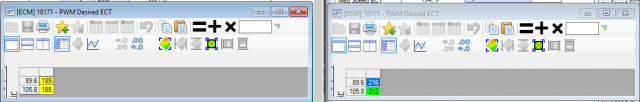

So I added a 180 degree thermostat. Manual labor was fun, had a lot of cool-aid in a zip lock, couple of drips here and there, added it back into the system and checked for leaks. Now my expectations were that as I adjusted the tune the fans would kick into ninja mode as soon as the temp hit 185. I didn't drive with music on so I could detect the fans coming on but the fans remained relatively quiet. Here are the tables I adjusted and the values they hold.
For High Speed Vehicle Mode, Low Speed Vehicle Mode and A/C On I set the values for Low Speed ECT to 185. Theory is that you want the thermostat to actually open before cooling, so at 185 a 180 degree thermostat should be open and the pump should be on. The fans then should kick on at 185 and the engine should cool off the fluid. At idle I was expecting the car not to see anything above 185 or damn near it, were my expectations wrong? Additionally I set High Speed ECT and Medium Speed ECT to 194. Since the FANS are PWM is there anything in those control options that I should adjust as well? Should I tell the fans to go full tilt?
I understand I may be asking too much of the system but do things look normal? Attached my log of after the install (had to add as a zip due to file extension restrictions)..
