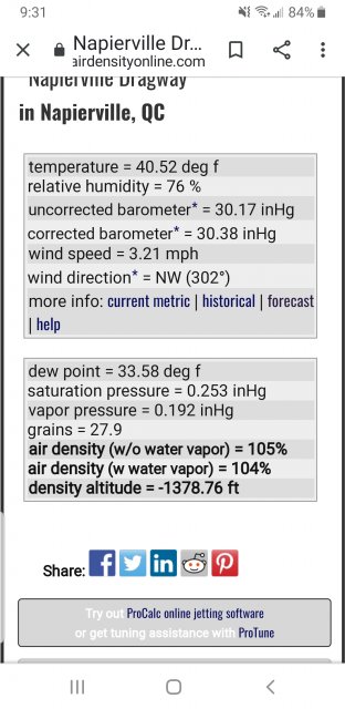

My car hasn't made any more boost in low DA vs high. I didn't see it stock, and I FOR SURE haven't seen it with the 2.72. I've run this 2.72 in 90 degree heat and 50 degree cool air and it makes 16.5psi no matter what. May not 100% answer the fueling question in DA changes, but at least from a boost perspective it should be the same based on my experience with data logging to back it up.
I was just going by what I have seen on the dash the few times I looked. Hot sweaty day in the summer I have never seen the gauge go over 10psi. In November
I have seen 12. Not scientific, just what I noticed on occasion.

This is the DA at the moment. Should be pretty close to that when the track opens. Imagine later in the month. Screenshot_20191004-213107_Chrome.jpg
