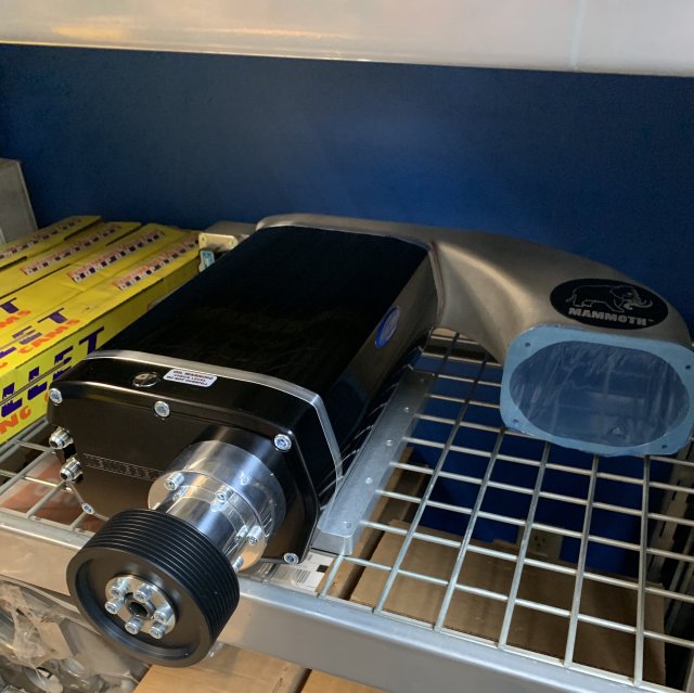

Nice!! Was going with the 4.2 KB vs the larger sizes based on advice or just availability? I think you are going to find that having the M6 is lucky. I’ll suggest that you look into the OST T400 conversion before you spend money on trying to make that manual work. Looking forward to seeing this come to fruition. Good job on your choices!

Marc- Kenne Bell was running a really good sale a while back so I ordered one expecting to stay with stock displacement at that time. Combined with my power goals of upper 900s to 1000ish at the tire. That’s still the case with this motor so I think the 4.2L will be a good fit.
I’m way over built compared to what the motor can handle but I wanted a lot of safety margin and room to grow if needed. For now, I want to keep a manual in it and that’s the reason for keeping the power low. I’ll likely enjoy it for this fall and then have RPM transmissions build it to their Level 7 this winter. This car is a weekend toy for me and its going to be about 70% street and 30% track use..... I really enjoy driving a manual so I’ll try it for awhile and adapt if I have to in the future and then turn it up![wrenchin]

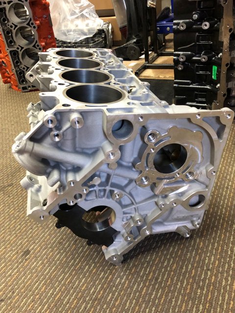

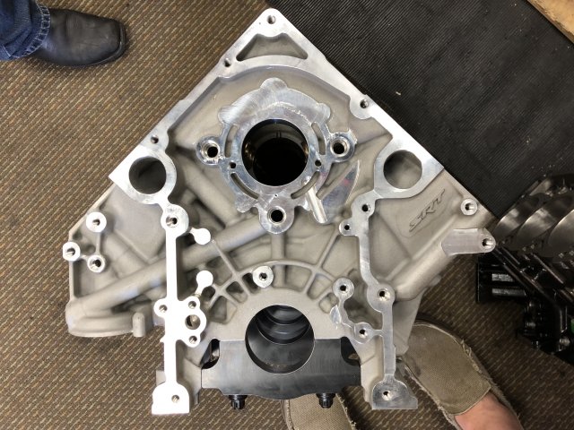

I was lucky enough to snag a Big Gas alum. Hellephant block for my N/A build. Apparently my builder can no longer get them as they are reserving them for dedicated Hellephant builds and race teams. Except for each end, all 4 bolt mains. Feeling very fortunate to have one. Eager to see how yours turn out. Should be a blast!
cole3986
#1028
1,061
1,364
Lawrenceville
I agree the block is hard to get, what bore size did you go with (there are 6 or 7 blocks listed in the catalog), really nice build, congratulations on scoring the block.
IMO, be careful with the M6, Gamble upgraded the M6 with transzilla (by Rockland Gear). It is supposed to be good for 1,000 ft pound of torque. He blew it up after a few passes (so I am told) and went to a turbo 400.
I forgot the boar size. Sure is light though. Easily picked it up myself. Builder says we should shave at least 130 lbs off the front.

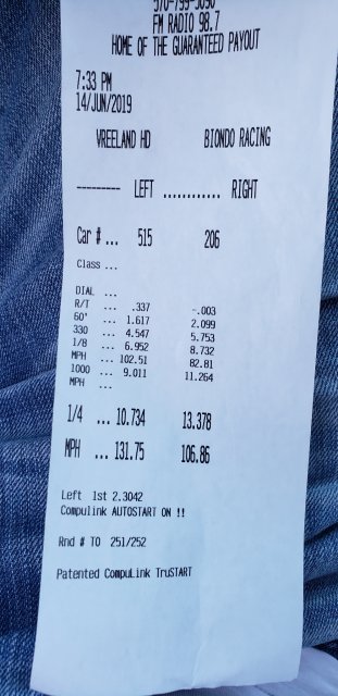

8.68 @ 163 I have broken a lot of parts getting there, I am trying to help you avoid the pitfalls I learned the hard way (if I can). I am not an expert on the M6 but I am in the game and read. The bolts used on the half shafts used by DSS and G Force stretch, please check them after every pass. They are the highest strength available, installing higher yield bolts is not an option.

Didn’t know I came so close to the M6 record with this pass
The 60’ did it, was my best ever, slipped the clutch for about the first 15 ft of the line. Did 2 1.8’s after that at 11.1-11.3 but that run my only 10 ever. Track prep was GREAT and helped immensely
