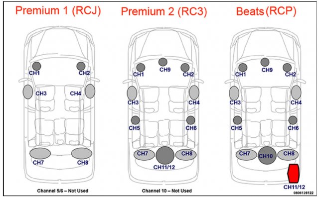

To address a few concerns, here:
No LOC necessary, if tapping off the DRIVER side rear 6x9. The entire passenger side audio signal is reverse biased. Been that way, since 2005. If you tap into the passenger side, you WILL end up with flat bass imaging.
OEM Alpine speakers, including the sub, are 2 ohm. Do not deviate from this.
Yes, you can, and should use the dedicated bass channel wires, if your cat is so equipped (not all Alpine systems came with a rear shelf sub).
A single source signal, for bass, is just fine. Aftermarket wise, you'll be running it into a monoblock amp. Bass is not imaged in stereo, so no need for L&R input, to the amp.
There is an HK dual sub box for sale, on Mordor (the "other" site).
I have provided a download link, in the Tech/Maintenance section, for HC Charger. It includes thorough audio package wiring diagrams.
I'm happy to walk anyone through the bass upgrade process. I am VERY familiar with modifying the audio packages, in this platform.
If you want to go full pro swap, with amps and new speakers, there are very good threads, here and on Mordor.
For reference, my HK dual sub upgrade totaled right around $500, in parts, and I dont plan on changing it. Very happy with the results.
Let me know how I can help.

Yeah... like I said... ALL passenger side imaging is reverse biased, whether it was Kicker, Beats, Boston Acoustics, Alpine, or HK. That's just the way Chrysler does it.
That having been said, if you have the base Alpine system, without subwoofer, you should tap off of the driver side rear 6x9, for an audio signal.
If you have a Premium 2 system, with a subwoofer, you should disconnect the subwoofer and tap off of that line, to your new sub amp high side input. If you don't have the OEM rear subwoofer, tap off of the rear driver side 6x9, and treat it as a high side tap, going into your aftermarket amp.
There is a negligible amount of roll-off, above volume level 22. I know there are devices out there, to compensate. In this type of application, I do not think they are necessary. We are not building competition audio, here. The proper way to compensate for this is to play a music selection at volume level 22 and tweak the amp gain and crossover frequencies, at the new amp, until your bass is acceptable throughout the range. It takes some doing, but you can get a very nice playback.
All audio imaging is handled by the cabin amp. That being said, it is compensated for, by also going to the correct speaker. For example, for forward lows, mid-bass (not mid-range) speakers are used, in the front doors. Mid-range speakers are used in the rear doors (if so equipped) and rear parcel shelf. Highs are handled by the tweeters (if so equipped) and by the 3.5" dash speakers. All Alpine speakers, in the car, are 2 ohm. Do not deviate from this, if upgrading the speakers and keeping the OEM cabin amp
