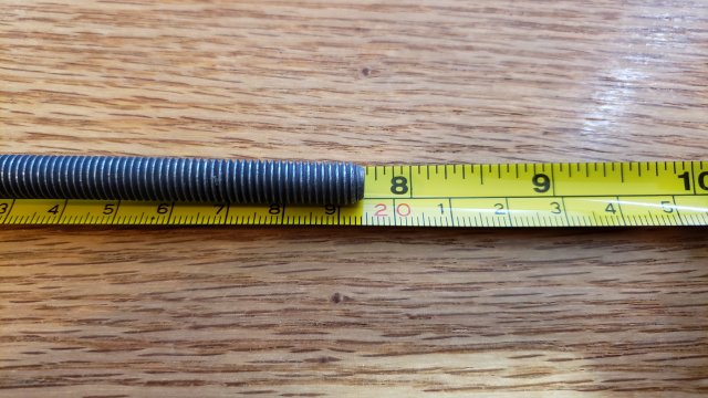

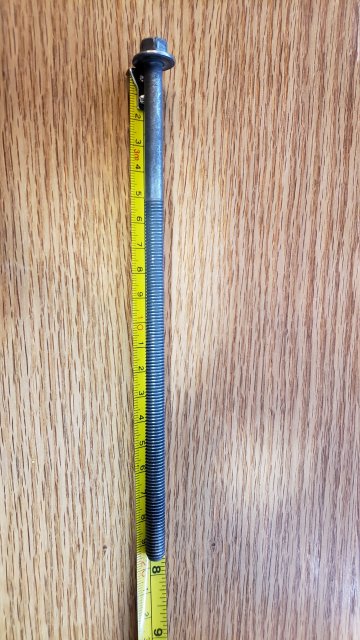

FYI:
Stock bolt length - M8 * 195mm with 15mm thread engagement
Spacer thickness - 10mm
Supplied bolt length with spacer kit - 200mm (with ~10mm thread engagement)
Has anyone had the "supplied" bolts fail? I am a big one for over-engineering any solution (the elevator principle) but I would have to suspect (or hope) that they would have done some destruction testing on this set up before marketing it. If not, there could be a potential case there for design defect...

14,768
45,375
If there have been failures, I'm not aware of them. But, clearly, there is MUCH I'm not aware of...
