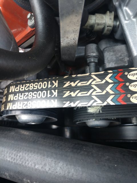

Any one use it? I just ordered it. Also I went to a k109594 rpm belt from a k100582 rpm belt. One and a quarter inches longer. I have a 10 percent overdrive on the bottom and a 2.50 upper making about 1k to the rear. With the intake spacers the 100582 was too tight by about a half an inch. The belt is starting to fray.
