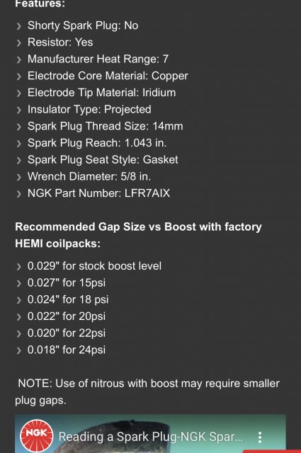

I guess the part number on the socket isn’t correct but this is exactly what it looks like (I know this one is the wrong size). You can put a socket wrench right on it and get them out without any additional extensions, maybe a 1” once on top of it for the back ones. Get this in 5/6. The magnetic part is amazing. Some of my best tools are duralast
