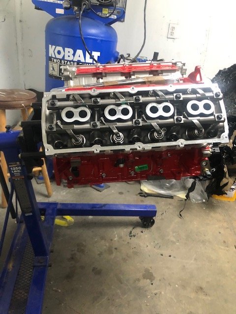

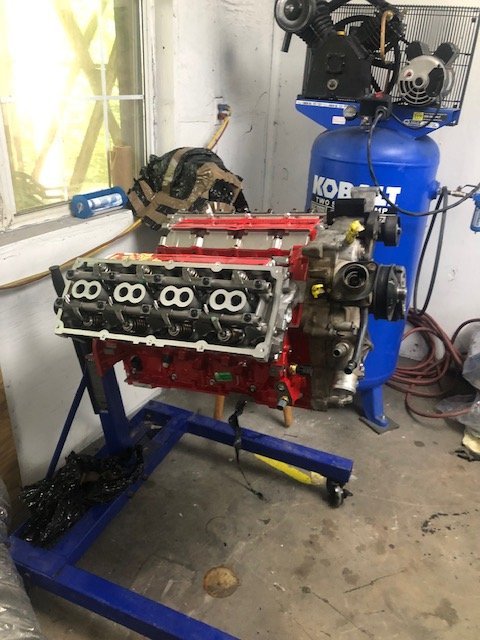

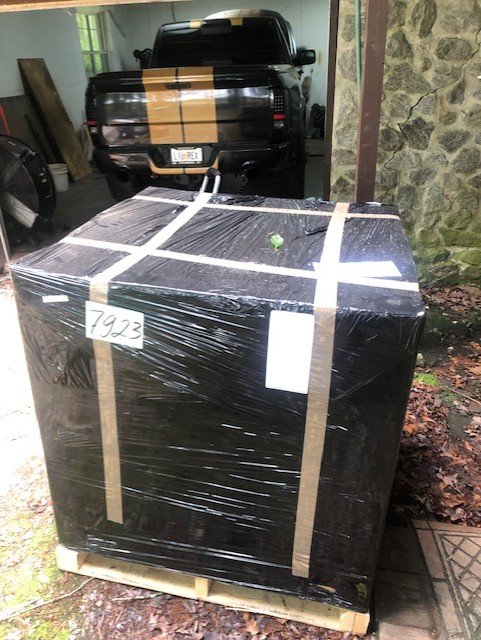

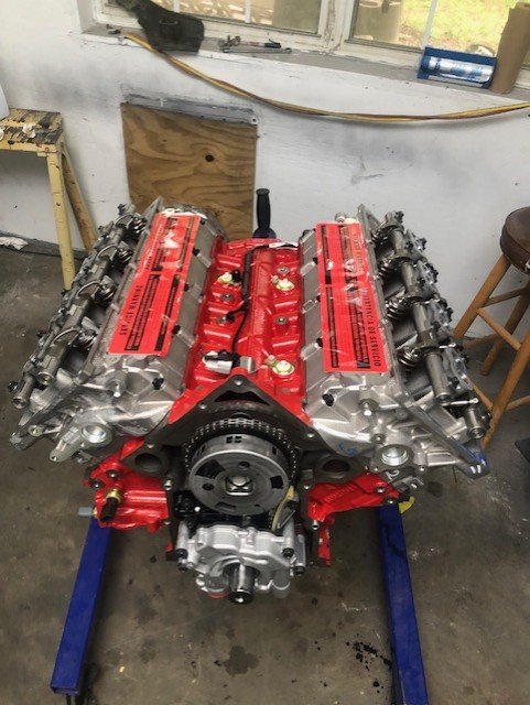

Well she came in today. I have her in the garage and on the stand. I can't wait to have her in and up & running. Demon 7.jpg Demon 5.jpg Demon 4.jpg Demon 3.jpg Demon 2.jpg Demon 1.jpg

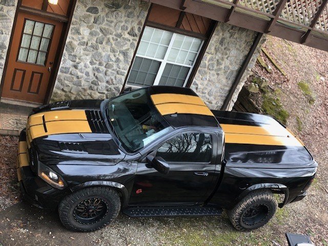

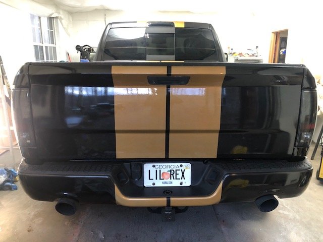

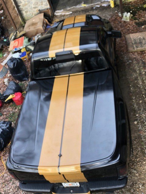

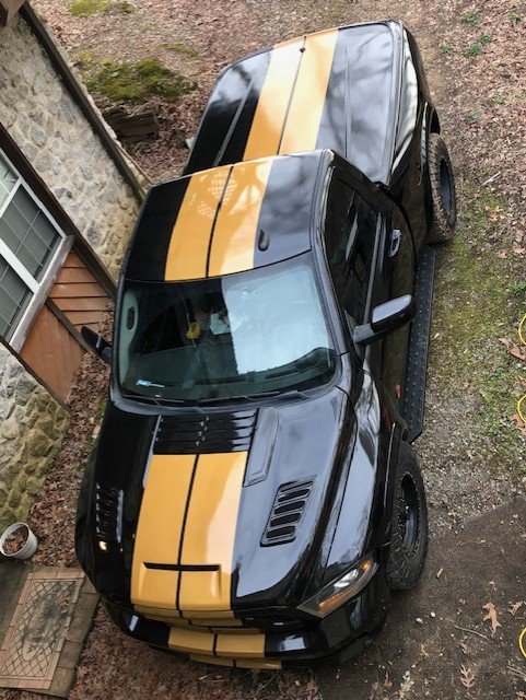

She had a fully built forged 5.7 Whipple with SW complete exhaust and a ton of extras. 18 months/ 45k miles and a valve spring failure...Very disappointing to say the least. Anyways with the Whipple 2.9, SW exhaust, fore innovation return fuel system, FRP tune and a lot of other stuff, this seemed like the best option. She was a screamer and once you go super charged, there's no going back... At least for me! ;) Anyways she’s a 2014 Ram 1500 Sport 4x4 with an advance fiberworks 8" wide body kit. She's riding on 37"x13.5 on the back and 37" x 11.5 on the front. Old school staggered set up. I've been building her every since I canceled my original TRX order years ago when they had a rough roll out. I've always loved SWB RC trucks and decided to build my own version of the TRX. I just never figured it would end up being a 6.2 Demon.
Thanks for asking!!:)

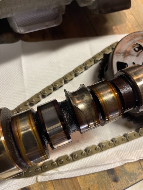

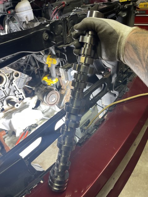

Cam replacement and headers, tune, hv oil pump, mds delete and vvt lock out done at this time. I’ve put 20,000 mikes on it since I got it done
Also I've change out the headlights with factory halogen black headlights. IMG_3807.jpeg IMG_3810.jpeg IMG_2579.jpeg IMG_2575.jpeg

Dang, that photo of the old cam makes me cringe! :-(

That’s one of the worst I’ve seen. You have me worried about my 5.7 now

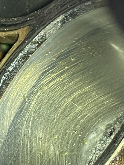

Went out at 187,000 miles. I upgraded and replaced everything I could putting it back together. Only thing I did not change was rotating assembly. Still has good cross hatch in the cylinders and no lands. I was actually amazed at how good the walls looked and I am pretty hard on the truck, I drive it like I stole it:love::cool:

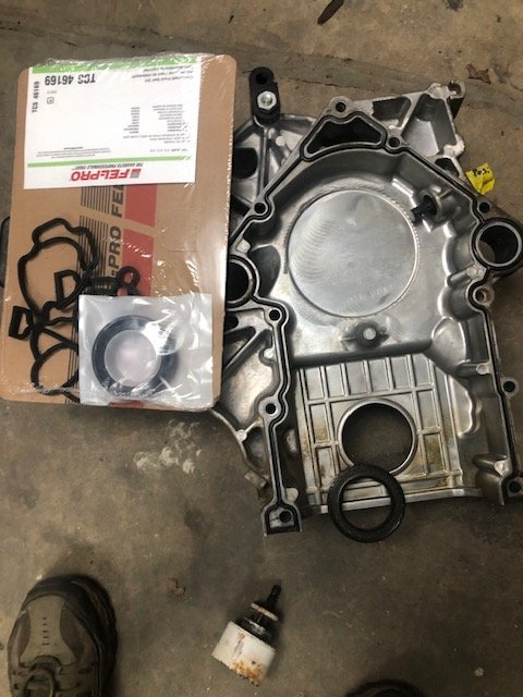

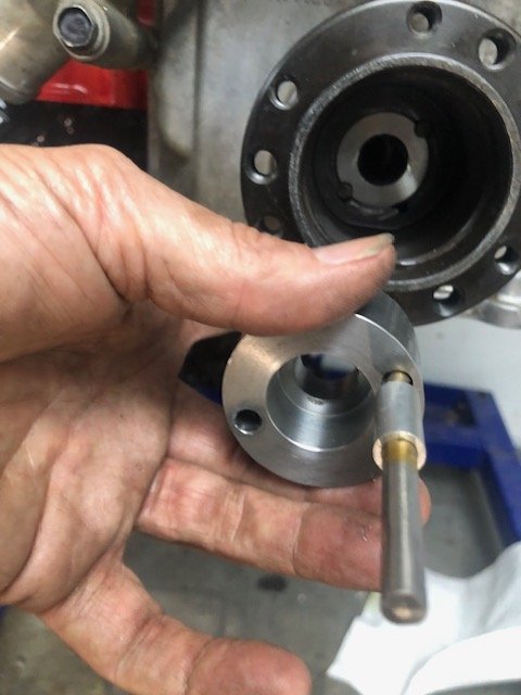

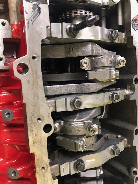

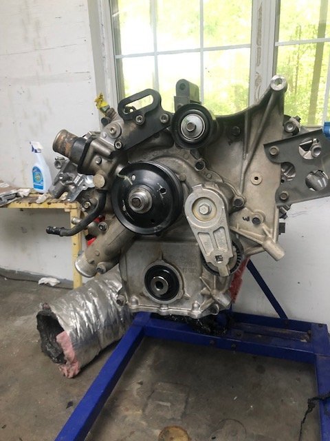

2 nights ago after work I installed the timing cover and water pump. I replaced the timing cover seal and gasket. When I tried to put the ATI damper bolt in to rotate the crank, I found my first hiccup. The bolt diameter was too small so I had to order a 6.2 engine crank bolt.
I also asked them about the difficulty I had putting on and taking off the ATI Super Damper. They said it had to be honed to remove the anodizing and heated prior to install. I must have missed that one in the instructions. Also after researching this on videos, it wasn't mentioned. But I am going to use the special tool used for installing dampers.

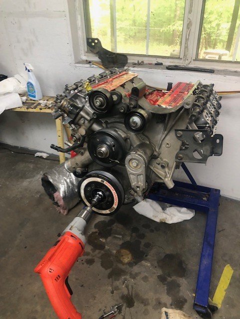

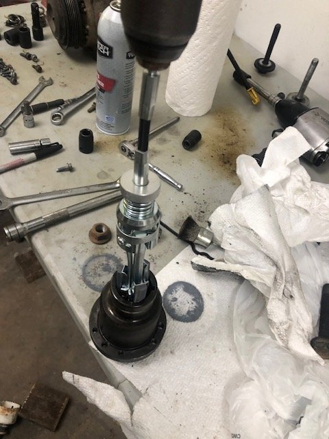

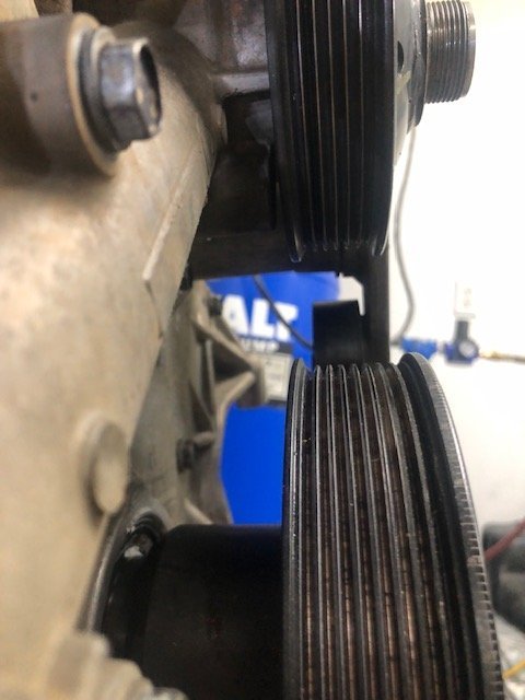

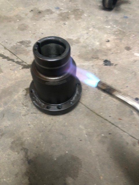

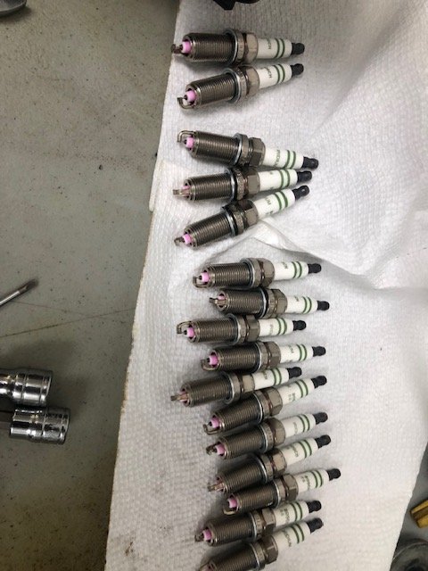

Last night I installed the ATI super Damper. First I honed out the hub a tad. I had to modify the tool to get it to fit the hub. I used a torch to heat it up a bit (not hot enough to damage the seal). I got lucky a found a bolt to pull the hub onto the crank (used plenty of assembly lube). Once the hub was in place, I used the Whipple pin drill tool, set the pins in place and when the correct bolt arrives, I'll torque it in to specs.
Another thing to know is that the LB comes with spark plugs installed so don't jump the gun and purchase some like I did. They will get used later so not a total waste! It was reassuring to see that the pull was lined up correctly so no issues there. If you will notice, the ATI pully allows for a wider belt when the time comes. ;)

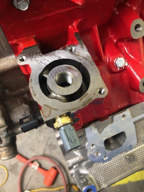

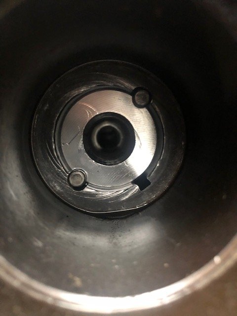

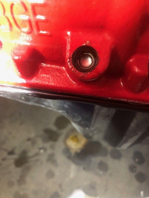

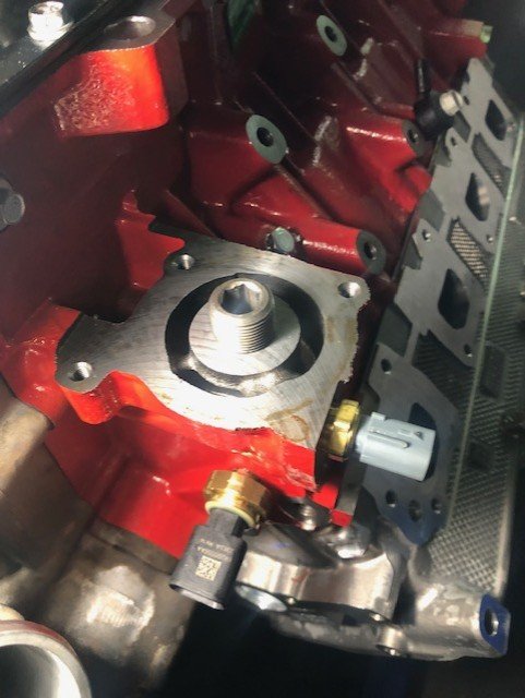

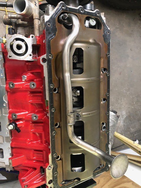

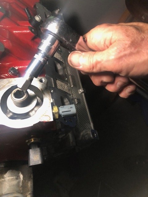

Yesterday I was trying to set up the oiling system. I wanted to prime it and make sure the oil was flowing before putting the valve covers on. 2nd hiccup was no threaded nipple for the oil filter. I wanted to pull one off one of the 5.7's to see if it would work. Unfortunately I did not have a 12 mm Allen head socket. I did get the plugs pulled for ease of rotating the crank. Also I can confirm the gaps are .028. For truck application (rear sump), you have to swap main cap bolts 1 & 3. Now the windage tray and pan can go on.

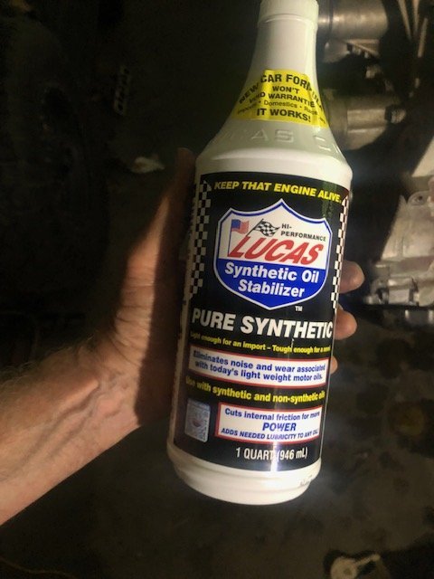

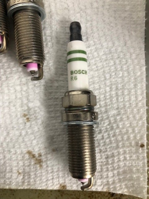

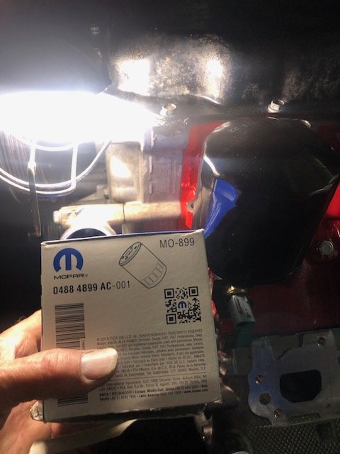

Yesterday I got the 12 mm allen socket, took the oil filter nipple off the 5.7 and it fit the 6.2! One thing not to forget is if you’re running a rear sump pan, be sure to knock out the dip stick plug before installing the oil pan. I completed the oiling system, filled her with synthetic M1 0-40 and a quart of Lucas, got her primed using a high torque drill and oil flow was great. I installed the valve covers, checked the spark plug gaps and installed,they were .028 (stock plugs were Bosch R6) before installing the coil packs.
