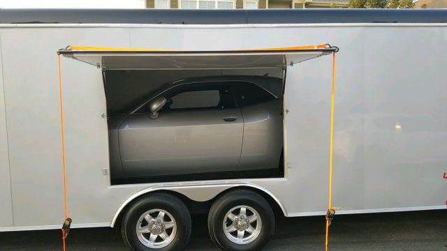

Do you have a smaller friend or family member? If they can drive have them either go out the window or crawl out through the trunk with rear seat down. The kind of trailer that allows doors to be opened are either ramp over or escape door types. Both are not cheap. The other option is to use a winch and pull the car into the trailer once it's on the rear ramp.

I am planning on putting in a escape door but still need to raise the car to clear the well.

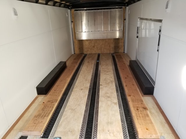

14,836
45,605
2x12’s
Simple, cheap, perfect rise.

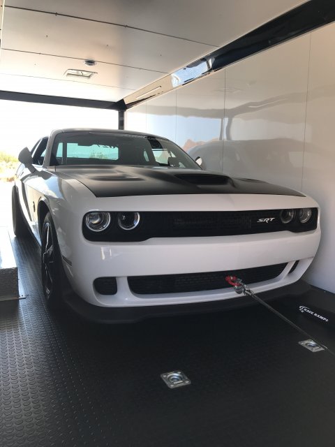

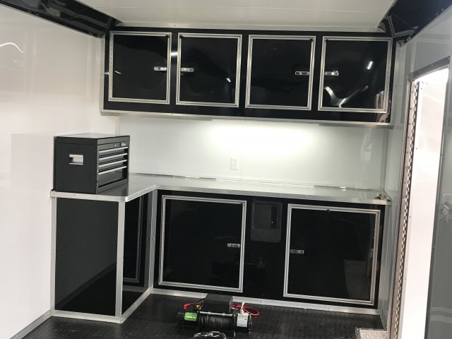

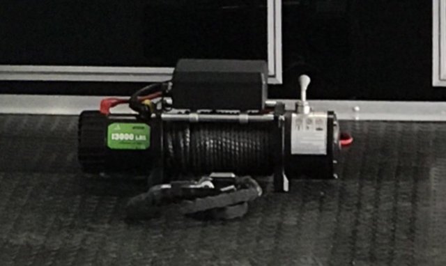

3,315
10,578
Use a winch. I have a 13,000 lb rated with a nylon cable that is very easy to use. It has a wireless remote that I can use while I walk along side the car with one hand inside on the wheel to keep it centered. No need to ever crawl into the car and that thing will drag that car in there with the wheels locked. You can get a big one like mine for less than $400. 54829732-CE3E-47C8-93E7-8D61F452D4C4.jpeg A1932C02-0630-477D-85AD-31C766B1F21D.jpeg 516C0649-93EC-4858-81B4-6DA22A7EE977.jpeg
