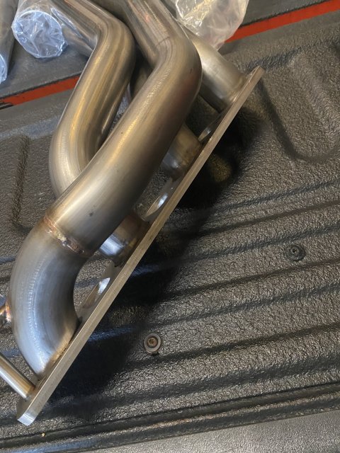

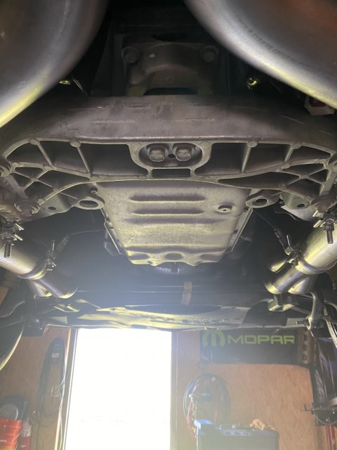

I’ve had these headers on the shelf for over a year. Since before I had the car even. Had some time and a helping hand so.......

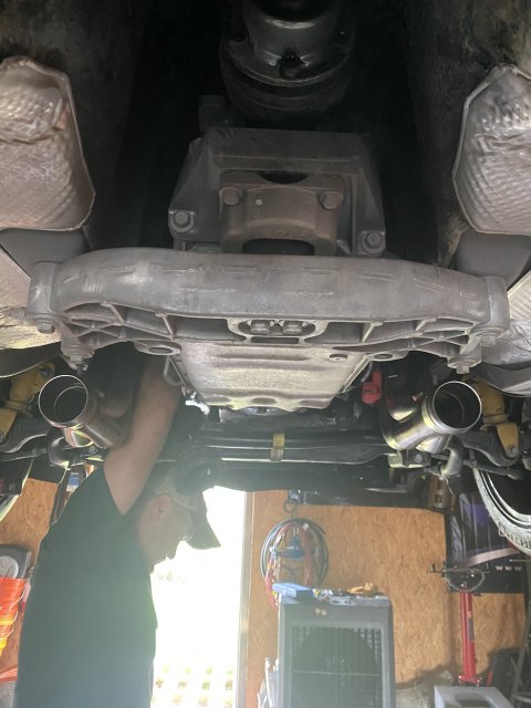

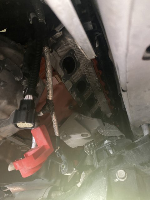

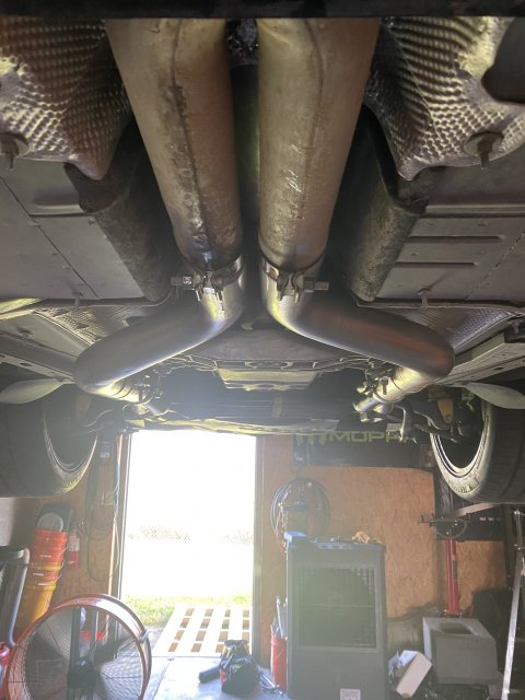

Went much smoother than expected.
dropped K member to the last few threads on the bolts.
got all manifold and header bolts from the bottom.
I’m used to stock bolts being too long and the TSP kit did not come with bolts.
I had a set of 12pt ARH bolts I found in the tool box.
the worst part was I apparently only have 1 12pt 10mm socket
I really was surprised to not only finish today, but I didn’t even stay late!
On my old '13 mustang I found dropping the k frame made the job much easier. I would unbolt it and let it swing down leaving the steering and such attached. I didn't look much at doing that to the Charger but sounds like it helped you.
