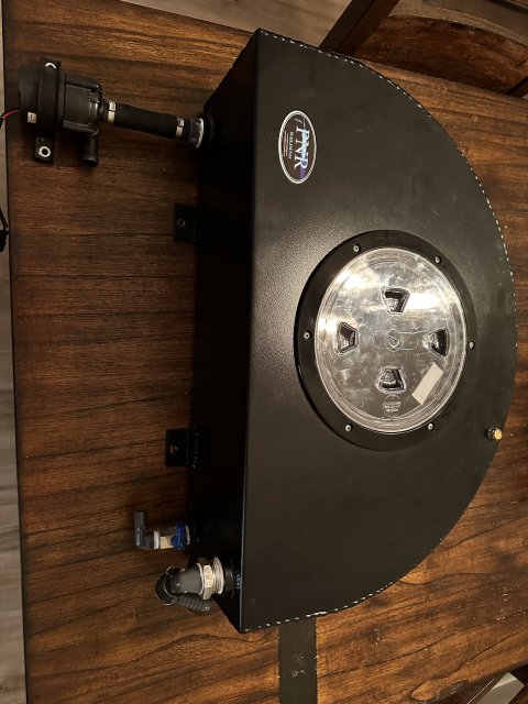

I plan on installing a thermostatic bypass valve for it to bypass the heat echsnger automatically, temps under 95 degrees? Bypasses heat exchanger to ice bow (or chiller only). Above 95? Opens up to heat exchanger. This is perfect imo in case you run out of cold fluid at the top of the track with the heat exchanger bypassed, and will save you
