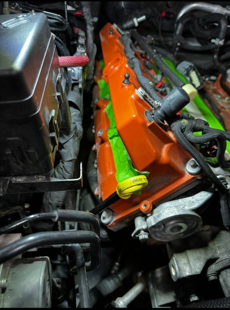

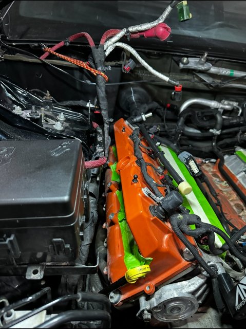

Alternator off. All coil packs off. Wires finally up out of the way
7000 Posts Club
7,326
6,085
#47
curse the engineer that put the oil pressure sensor (green plug) in that same loom of wire. Past me didn’t lock the white sliding lock clip when I put it back on the last time. Thankfully. Only reason alternator needed to be completely removed was to unplug the oil pressure sensor behind it so that the group of wires could be moved out of the way
