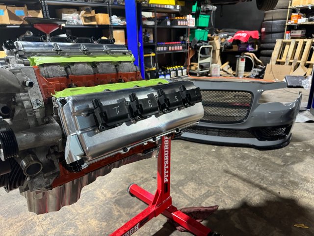

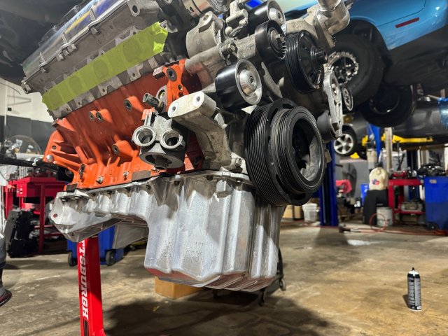

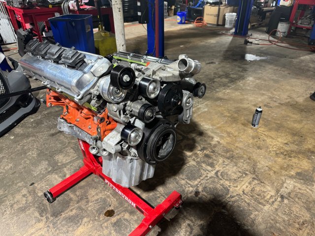

Final push before dropping in. Have a lift all to myself Nov 20th - Nov 22nd. Off of work and eager to get this dropped in. Then next hard decision is where to put the hellcat during winter or do I work on the racecar.

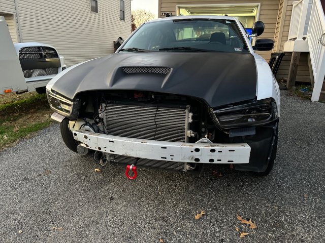

cut off the cancer on the passenger aide from the accident. Mounted a tow hook. Motor goes in tomorrow.

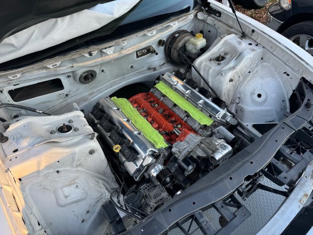

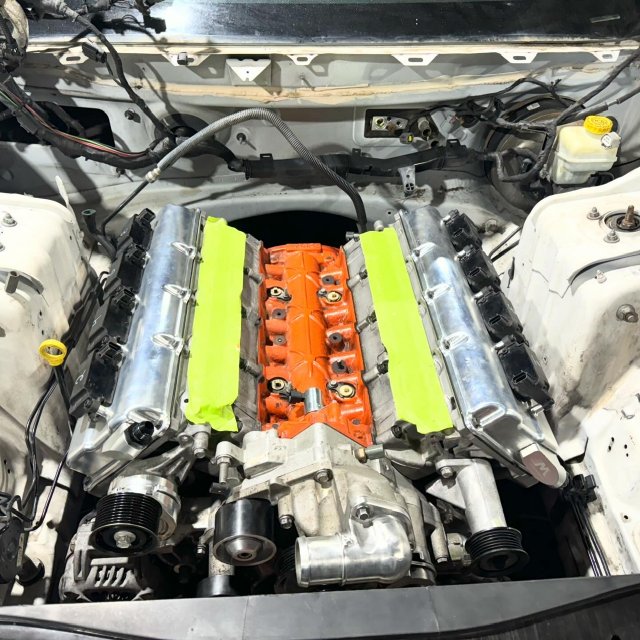

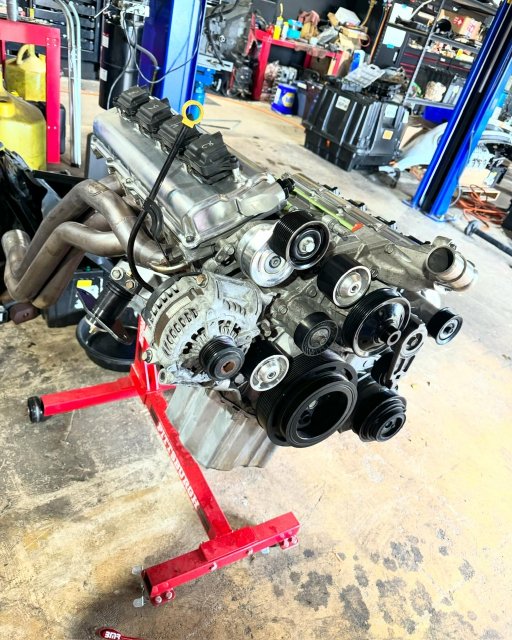

D4358422-1C81-4703-93C0-0CD147F66F1C.jpeg 63124AEB-BC8D-4FF3-901F-814954E31761.jpeg
all the room for activities. When there are no original components left its quite a huge engine bay!

Thread Starter #168
sorry forgot this pic, it really is a blank canvad

alternator is going to have to come off for oil pressure sensor ask me how I know

And the alternator is going to have to come off again to be converted to a one wire. If you haven’t done that already…. you’ll need to if you go with the Holley EFI. 😁

already done and happy thanksgiving

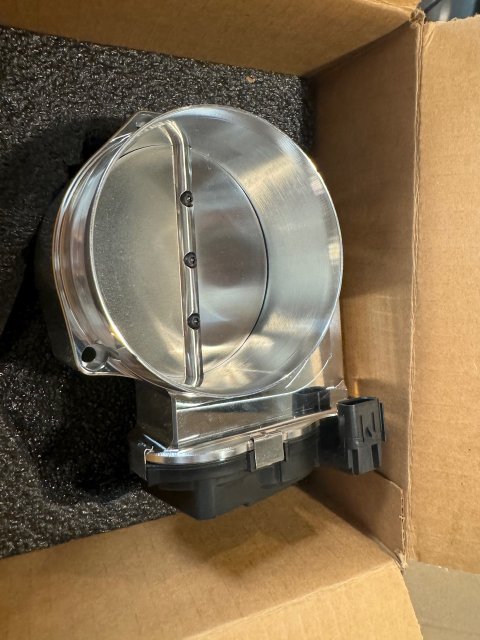

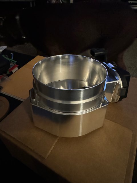

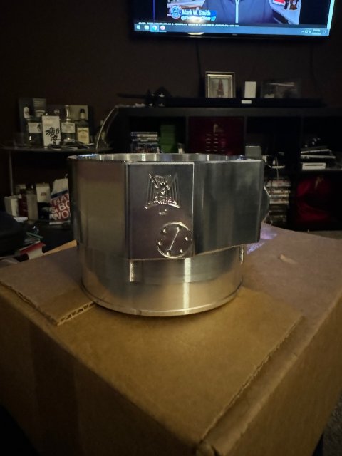

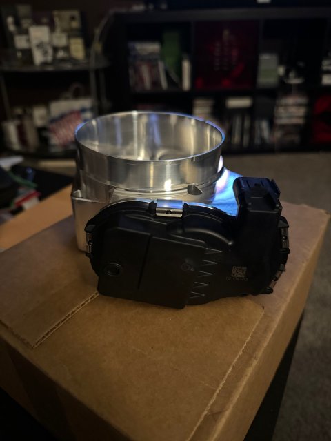

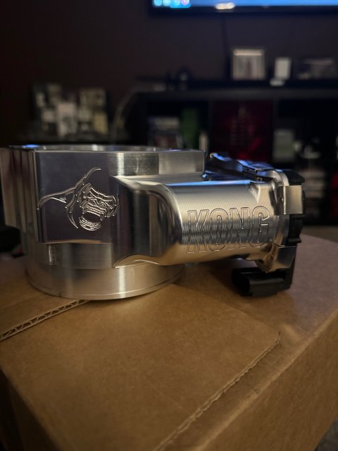

This beautiful piece arrived. If you have a 2.4 and are not running a Kong, you are wrong. Plug and play and allows globs of air in. It will be paired with a legmaker intake.

So how is this different from the nick Williams 108, since it’s a rebranded nick williams. NW one requires a ported snout and a gasket, this one does not?
You're making too many assumptions, this does require a port match. Mine is being ported by Kong.

Really, just to operate? I know the regular nick Williams one (hundreds cheaper) requires a ported snout or the throttle blade will interfere with it. I always thought the Kong one was maybe thicker and the blade wouldn’t interfere with an unported snout
they are exactly the same dimensions everywhere, only difference is the kong labelling and support, if I have an issue, I go to kong and they replace it
if you have an issue with the nick williams who does the support? the third party vendor and good luck with that, watched a shop eat shit with bbk and granatelli throttle bodies through no fault of their own...
williams https://williamsperformance.net/ does not do direct sales
kong has been the one company to stand by their product and my 2.4 on my hellcat can be spun to hell and back and not even break a sweat, the cooling bricks though can't keep up, but we'll be fixing that soon: ts/mopar/noforn readins required :)

I’m currently designing a 2” spacer with custom ic core for the lid with an air foil to direct the air through it.
