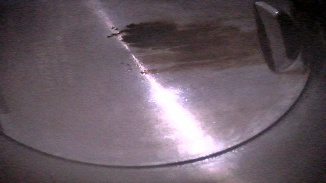

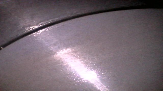

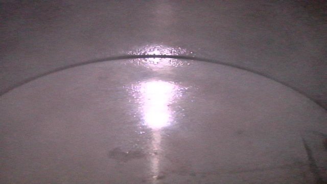

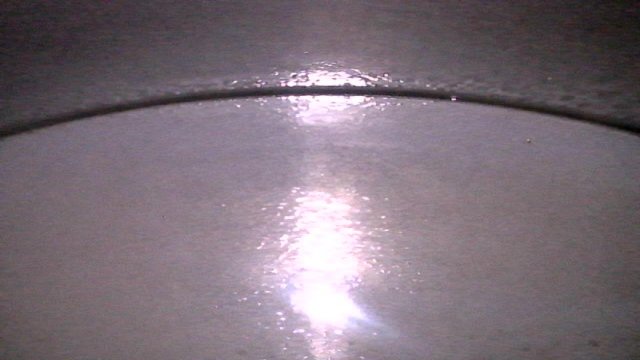

Cylinders 2,4,6,8 no longer have pools of oil on them. IMG_8068.jpeg IMG_8071.jpeg IMG_8076.jpeg IMG_8081.jpeg
#2 still has some cleanup to do but with time…

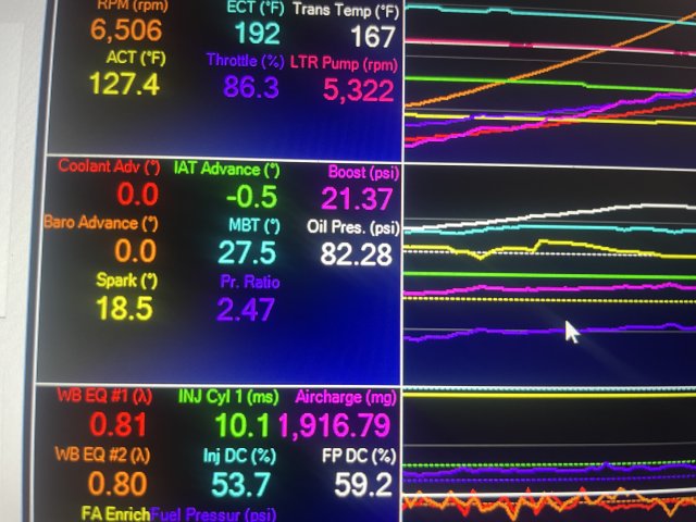

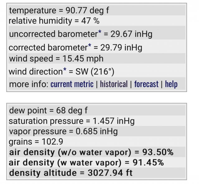

In 3000 DA made about 21psi of boost and almost shit myself.
the key to this is communication, MMX, Mike and I all got on the same page about motor break in procedures, oil they want me to run and how to maintain the motor.

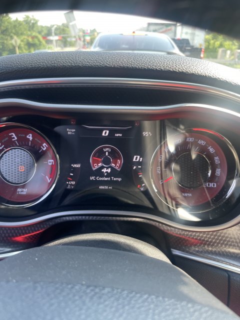

almost out of the woods. Now the problem is how to get the IC chiller temps colder faster. Might extract one gallon and replace with distilled water and see how fast it gets down. On 94* theres only so much you can do with the stock coolant as it fights
and finally one of the exhaust donuts got dorked on installing, have to fix that

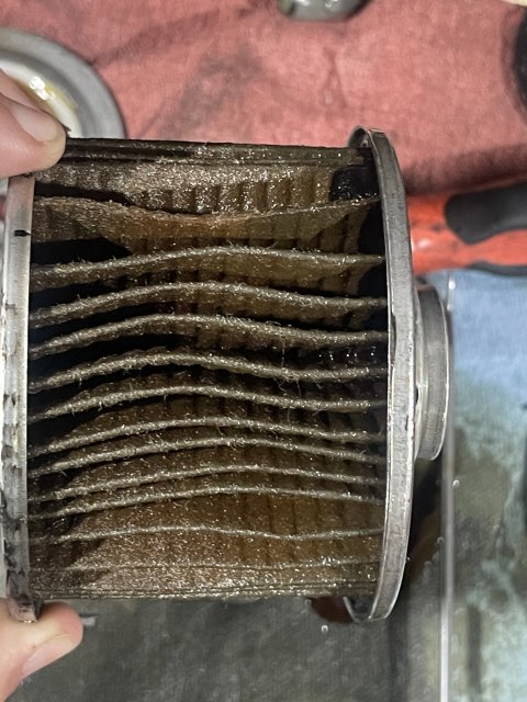

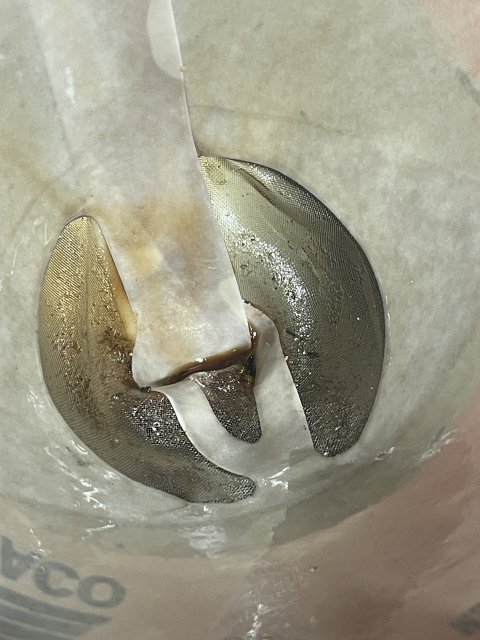

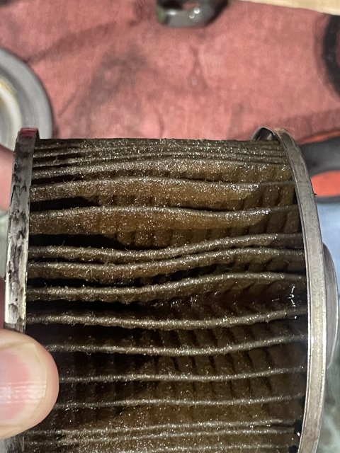

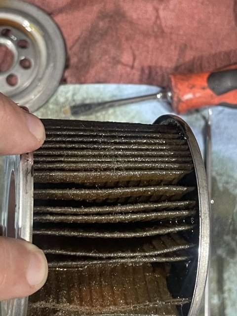

Also we cracked open the oil filter and we also ran the break in oil through a filter
for break in oil this is expected.
40,842
177,294
Are they flakes or reflections?

Don’t sell the car. Send it man, glad things are looking better. 45 seems good, is that with drag valve on? How long did it take to get them that cool?
Both this is expected also little pieces of rtv from the front seal as you install the timing cover on a new motor
Drag valve on, too long about five minutes.

With yesterdays humidity and heat that is actually very impressive. 51 degrees below ambient. That system is cooling more than effectively.
That’s intercooler temps not IAT. I hate that no one shows IAT
7,636
6,424
IAT will only ever be 5-10 degrees below ambient with a chiller
I always show iats and they were 75 degrees cruising on the highway. Keep in mind the only way the 2.4 gets cooling is passively. Without large volumes of air it will always be hot. When I hit wot they went down to 60.
