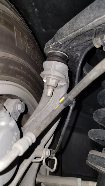

that's the upper ball joint bolt/nut. I don't see why you would loosen that for alignment. I am betting it wasn't tight from the factory, and just worked its way off

Either the nut was never installed, or it was removed on purpose. perhaps to steal the wheel. The ball joint nut is a squash nut, (self locking) nut. it wont fall off on its own even if loose. That could have been deadly. God was riding with them on that trip.

Who would attempt taking apart a ball joint to steal a wheel? Also I don't believe these ball joint nuts are locking (nylon or otherwise) pretty sure once it is lose, you can spin it off with your fingers
It's common practice to steal the whole knuckle. But that is just one possibility. and your wrong about the nut, It is a self locking design made to not need a cotter pin like the older cars had. When installed it is impossible for it to spin off if it is not torqued down as required. for this very reason. So it either was not on there from assembly, or someone removed it period. I'm leaning towards someone removed it. And it was not done to do an alignment ! Unless it was a total dumb ass that did the alignment. I will add that ALL suspension and steering components are held on with self locking nuts or as in older models castle nuts with cotter pins. I would also check the other side of this truck to see if it has been tampered with. They were on vacation, possible vandalism at Hotel/Motel parking lot? I am a certified Master Mechanic of 40+ years and know what I'm talking about.

I mean, I get what you are saying about not having a castle nut and pin, however I am telling you, once it is free from the spindle, even a little, you can turn them off with your hands. And if you can do that, then they can vibrate free. I am taking cars, even newer Challengers apart all the time, and while yes when torqued down those nuts hold, if they are free, they can come off
If you enlarge the photo of the truck spindle. And look at the lower ball joint you can clearly see that it has a lock nut style nut on it. If what you say is true, Then the nut is defective. Because that is why they went from cotter pins to lock nuts. So that failure to put the pins in wouldn't cause a failure.

so you're telling me, when you break the ball joint lose, you have to ratchet it the entire way off? At no point can't you freely turn it by hand during the removal or the installation process?
I have never seen one that acted that way
That is the way it is supposed to work. If they have been removed and installed multiple times in it's life. Then they may be worn to the point they no longer hold. and should be replaced. As new and installed, it should have to be racheted off all the way. What you describe may be another example of good Chinese manufacturing ( loose tolerance)

I suspect they will be examining the surface where missing nut contacts pretty closely. In the picture it doesn't look like there is any evidence of contact but the picture may not show it clearly.

They are a self locking nut, and my big hands cannot spin them loose...need a wrench myself.
They are not supposed to be reused, one time, then replaced.
I can't say for sure, but if I was placing a bet on it, someone tried to steal it. Parts are expensive, and thieves will steal anything and everything.

Confirming that on current gen Mopar, the spindle nuts are self locking.
Also that they are technically "one use only" nuts, I will deny reusing them.
This is the upper control arm of my 2020 1500. Definitely a nylon lock nut. Like has already been said, it was removed, or was never installed. It won't just vibrate off. I suppose it's possible the nut was defective and didn't have the nylon insert, but in that case it would have taken a lot longer (if at all) for it to work it's way off. Everything on those assembly lines are idiot-proofed as much as possible. The station won't release the truck until all torque values are met (both the number of fasteners and the final torque value). So it's highly unlikely it wasn't installed (although nothing is impossible). Either way, that sucks balls when your brand new vehicle fails in a major way so soon.
