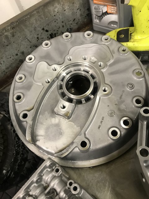

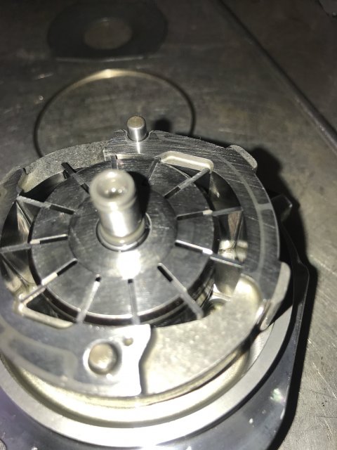

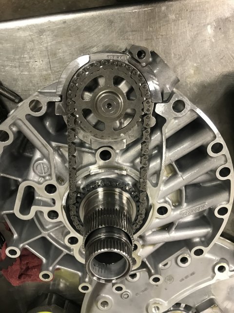

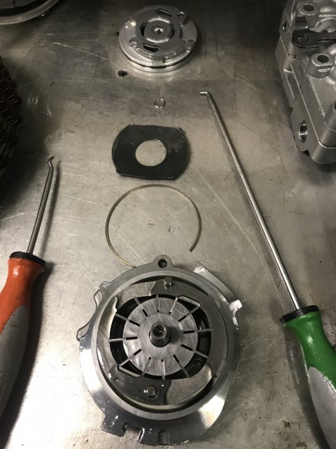

Here some pics of the pump , I got a call from Eddie at southern hotrod today very nice guy to talk to he suggested checking the pump because they do see issues particularly on the hellcats my pump checked out to be like new which I suspected it would but while it was apart it only made since to check it it has 7 torque to yield bolts that hold it together so be prepared to buy them as well, Eddie told me that they have not found the limits on the pump yet amazing if you aske me because it is a small pump , he also added that though they sell the koleen steels they can’t say if they actually make a difference or not and gave me the impression that he didn’t think so B395F129-749A-49E7-835B-D5B260BB9F7D.jpeg 1C432FE8-E50C-4D8C-AB58-B9CD8DBDBAFC.jpeg F10F2F70-3534-4AFD-A0D0-007461639996.jpeg

Here some pics of the pump , I got a call from Eddie at southern hotrod today very nice guy to talk to he suggested checking the pump because they do see issues particularly on the hellcats my pump checked out to be like new which I suspected it would but while it was apart it only made since to check it it has 7 torque to yield bolts that hold it together so be prepared to buy them as well, Eddie told me that they have not found the limits on the pump yet amazing if you aske me because it is a small pump , he also added that though they sell the koleen steels they can’t say if they actually make a difference or not and gave me the impression that he didn’t think so View attachment 7786 View attachment 7787 View attachment 7788
