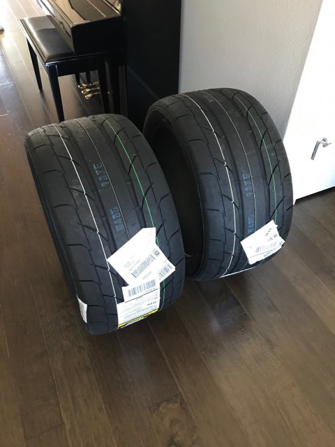

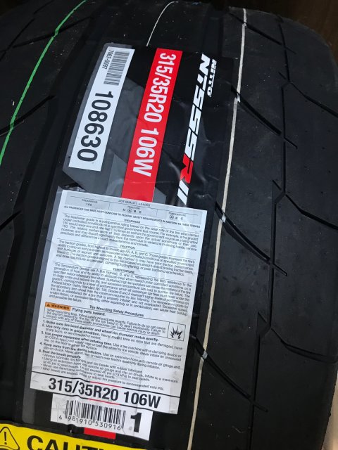

Hey Guys, I just received the new Nitto 555RII in the anticipated 315/35R20 size! Will be getting them installed on my WBRE tomorrow.

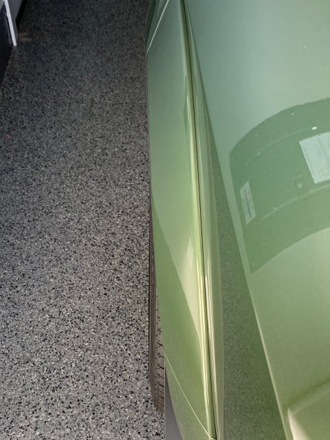

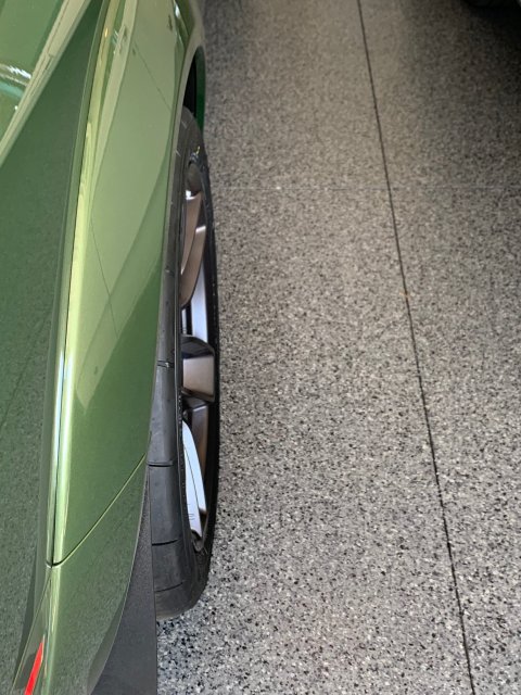

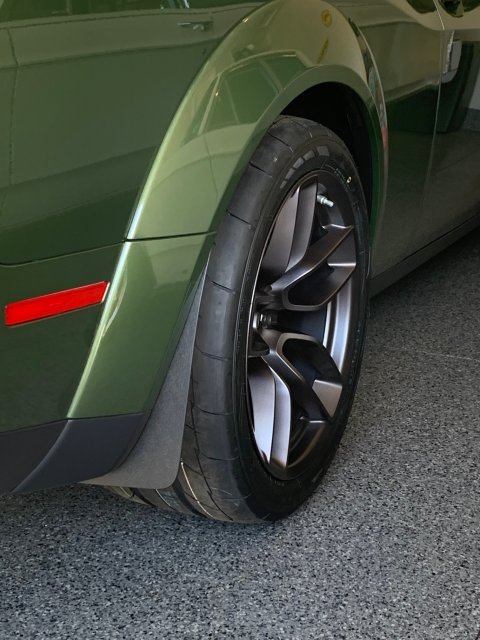

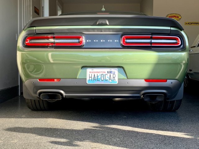

One side mounted.. did it for a comparison to the factory PZ4 summer PZero. Width is just shy of 1" wider when mounted on the factory 20x11. Height about 3/4" taller. Here are some pics. Driver side is factory, Passenger is the 555RII. You can see the width difference as the tire matches up to the rock guards.

The game changer for these 555RII is that they are W speed rated, are traction rated A, and have a 106 SL load rating. This means they have excellent rain traction and at our factory rated tire pressure of 32PSI, they have similar load capacity as the factory Pirellis. Super planted in high speed corners, and a 30MPH roll has zero wheel spin or hop.
