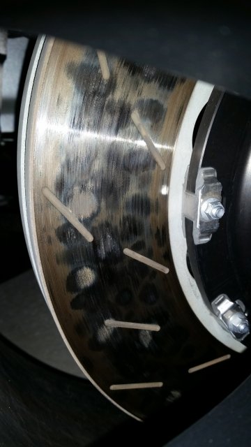

Z26s are good for aggressive street driving and if bedding correctly/well can have really good initial bite and stopping power.
That said, their initial bite is not quite as good the O.E. pads, they will fade if used on a race course and will severely heat check your rotors if you do.
Bedding is key to making the Z26s work well, if you don't, they will be subpar.

Z26s on O.E. rotors used for the Colorado Mile.
Oops.
