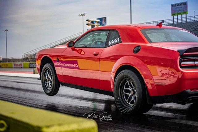

@DRAGRCR, how are you liking the 315/55r17 mickeys? I’ve been thinking of switching to them over my 315/50s. Do you have any more pics of them on the car? I’ve read they should be about an inch taller than the 315/50s?
They are 1.1" taller.
They are 3 pounds heavier, I think.
Wilder said they tested them and the car was slower. I agree. In higher DA with killer prep the shorter tire will be faster.
They will damage the car.
I like them a lot. In fact I may never run the shorter tire again.
They are NOT a cure all. You still need amazing prep and knowledge and skill.
Example, I made 18 passes in Bakersfield on a T&T Weekend. I could never drop the hammer. Not even close.

That is a LOT of wrinklage.

21 PSI and you can zoom in and see that they have not moved much. I think 2" total in 10 passes. The other white paint mark is the light spot of the tire (where the weight goes).

That thing has some mad wrinkle...either too much bite or too much rub on the hit?
