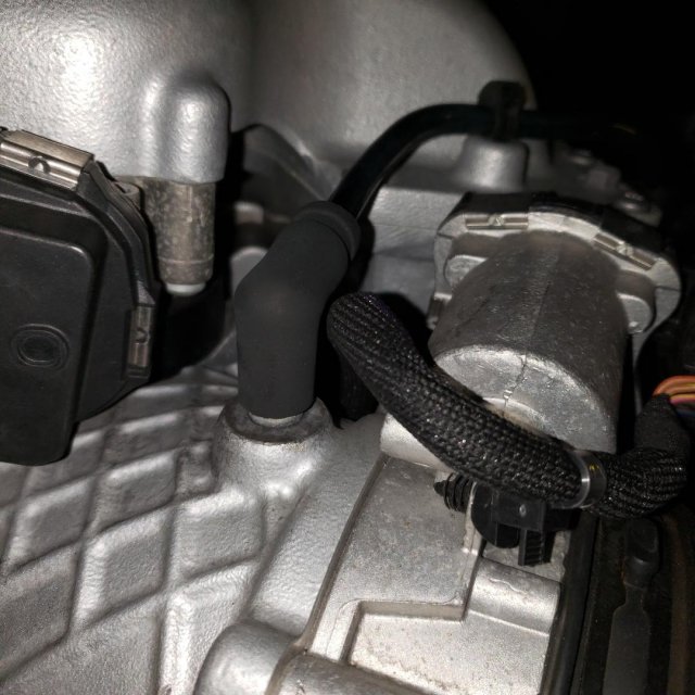

I have seen a post about this somewhere here and I just cant find it. This rubber connector is going bad on my HC and I would like the info to fix it. Thanks, everyone!

Is it getting that white film on it or is it actually dry rotting and cracking?
The white film can be cleaned off and treated with a variety of cleaners.

Hit up @Diboblo with a PM. He had this happen to his car a while back & as I recall had to order a whole box to get the 1 he needed.
He was giving them away at the time as I recall.
It is getting soft and when touched my fingers get black residue on them.

My car is 6 years old. I should probably replace mine as well. let me know if you get a hold of him. his post is from 2020.
It has dry rotted and every time you touch it,, will get worse. There is a way to do this. Wish I had a video to show. This is on the rubber elbow that has pulled loose from it's connector,, correct? If so easy fix.
He did get a hold of me, he is sending me one of only 2 left. He told me it is 8mm spark plug wire boots.
Thank you
Since it will be rubber again. I wood advise to coat it with a rubber based coating you can get at home depot. Just let the paint dept know what you are using it for. I have a quart here specifically for rubber. Called Armaflex white coating. But you can tint it to any color, they will do it for free.
