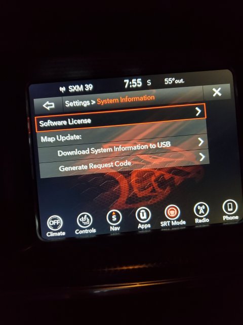

NYCSRTATE
#1768
259
731
NYC
2017 Charger Hellcat.
I can't even get to see what version im on.
Settings/System Information: see attached picture, anyone else's look like mine?
I check the uconnect site and it says my version is up to date.
No ota nothing.
Why can't I see what version im on?

I know how to get there, I'm saying when I do navigate there I don't have a version tab etc like you do.
As per my pic, what model year are you?
4,325
17,384
I have a screen on my '16 Cat that looks just like what Bob posted, but on my '18 Durango there is no software version # :mad:
