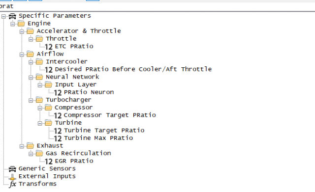

I'm trying to get this setup but which parameter are you guys using for PRatio? I'm still a bit of a newb with VCM scanner.
“pressure ratio” dont abbreviate
Well that makes all the sense I even typed pressure and saw that one. Thanks!
