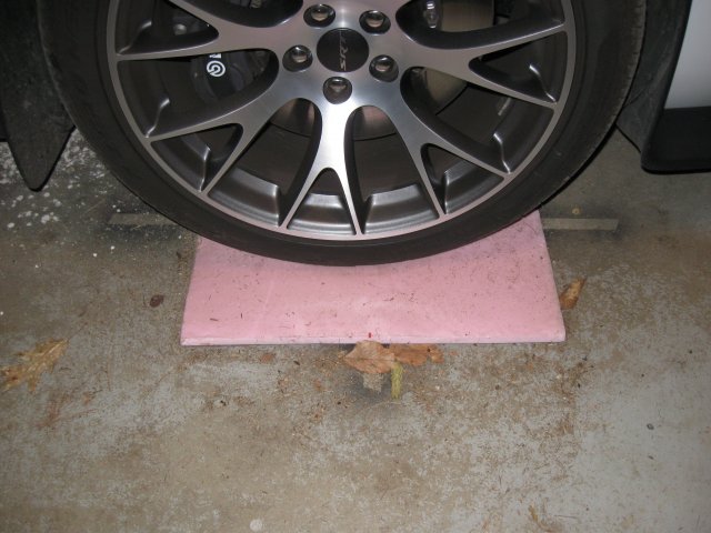

The easy solution to flat spots is get some 1/2" thick pink foam sheet insulation and cut squares to park on.

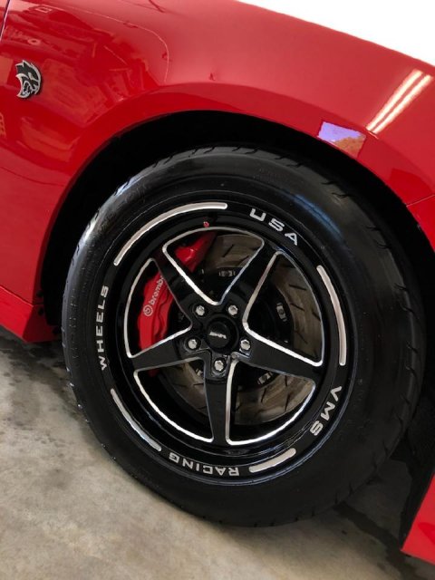

Mine definitely move. They were marked and the detail guy rubbed them off with tire shine.
They'll need to be rebalanced after this next event.
