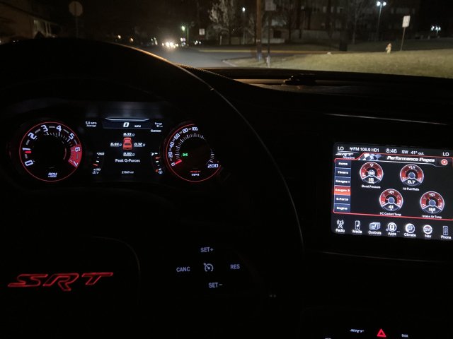

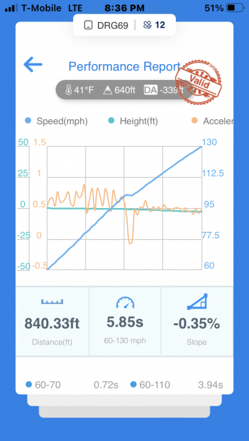

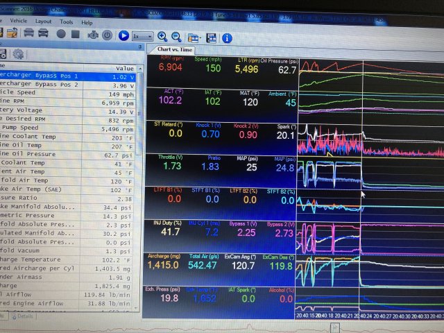

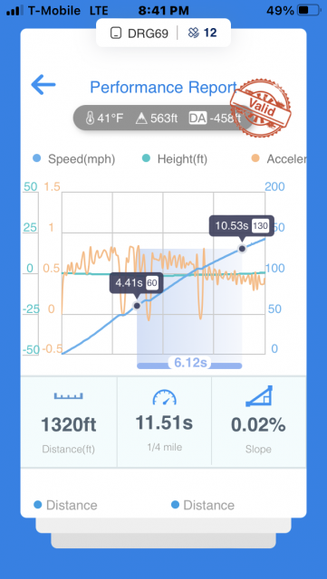

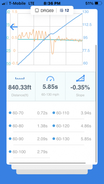

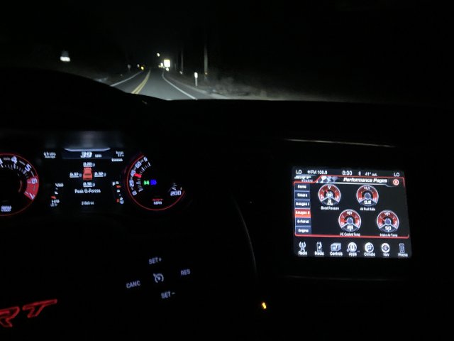

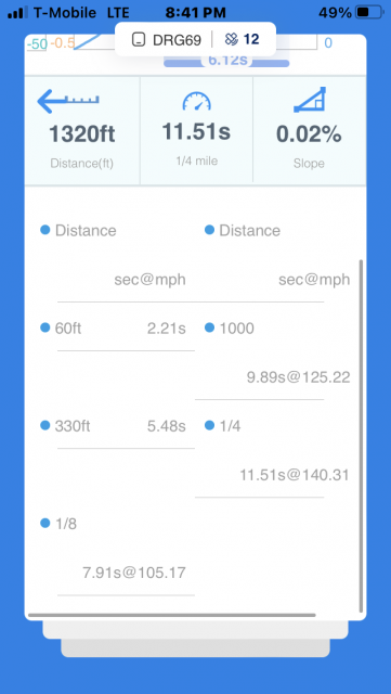

My drag size KC last night, before a 60-130 pass and 5 minutes later 1-2-3-4 1/4 pull to 150 and 5 minutes later my temps again. Notice the time stamps. Coolant started out at 26-28 F and ended in the 40’s. I run a +10 lower and 2.74 upper on my ported 2.4 blower making 21-22 psi. I’m happy with the KC, it’s been running almost 4 years now and I’ve never added anymore Freon or even touched it, or had a problem with it.
1E743E1E-15C3-4DE8-8BDE-E92D70BD1ABF.png C0B3D3AF-825A-48A9-8C75-44D3562A5530.jpeg 5CC91066-1BA7-451E-9332-9F21AC86F1FD.png 7A41A95A-12DD-4086-8C7F-FE86A94152EC.png FABF8D59-DF27-42DF-AD6D-9B745251AE95.png B9B86C63-F58A-4EA7-8744-46ED380794CB.jpeg 87DB6712-9DCD-4AA2-B8CC-BE4589583FD2.jpeg

Thanks Mike! Some really good data there. I had a KC before, never installed it. I don’t like how they didn’t move the pressure valve, is bad for the compressor because a lot of the refrigerant gets caught up. The IC unit looks great, did everything how it should be, I like how it’s plug and play
