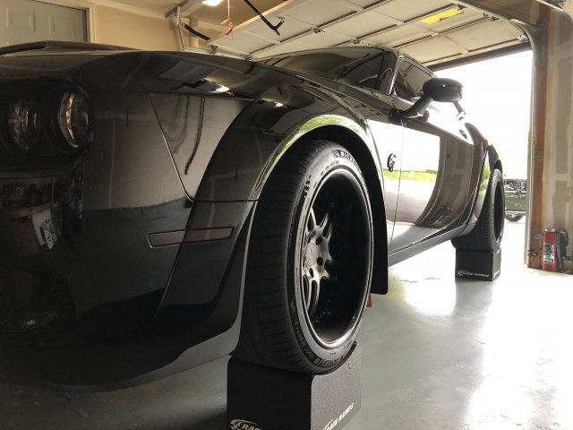

Did some of the final work on the CSL ceramic coating and some detail work. View attachment 17957
BULL that looks super clean. How many hours you put in on that to get it to look like that? Only problem is you gonna want to take it through the desert at 175 now? LOL.
5,847
38,229
Curious as well @BULL. Honestly, I'm a little reluctant to start such a daunting task nor sure I have the patience. Now that I am not daily driving it I know I can easily do this over multiple days. I ordered a detailing light (white is so hard to see imperfections) so I am planning on doing mine soon.

Given that this was my first "real" "paint correction" attempt, I went really slow, even practicing on our old Durango before hand.
But still, I went forward with the "Do no harm" mentality. So that made for extended efforts.
So with that said, I broke it up into the following steps, kind of, one "day" each, "days" varying in length by a fair amount, and with days off in between. (Mine's a garage queen, so no exposure between steps)
Wash and claybar, taking off Mopar flaps
Orange pad and V36
White pad and V38
TWO days of meticulously detailing seems, PPF edges, nooks, etc.
Wash again, followed by IPA panel wipe
IPA wipe again, CSL application
Sit in garage and cure for almost a full week
In hindsight, I wish I had done the EXOv4, I experimented with Meguires Hybrid wax today and I don't like it, so it's only on the rear valance.

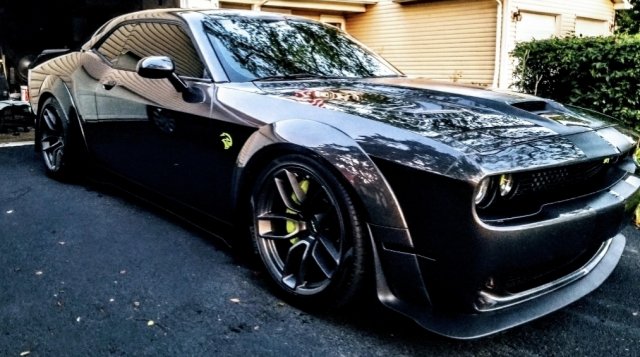

Drove her like I stole her! Chicago was 74 and clear. Triple digits 1st time this year after her bath! Screenshot_20200530-014956_Gallery.jpg

Drove her like I stole her! Chicago was 74 and clear. Triple digits 1st time this year after her bath! View attachment 17974
Tripped me out.
Shadows on back side actually made body style look different.
Beautiful!
