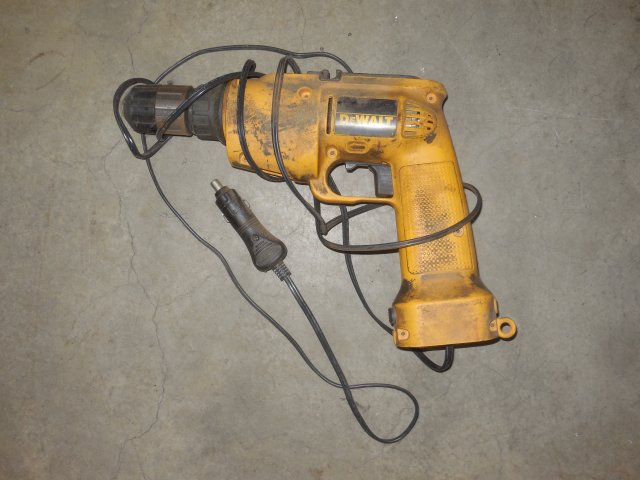

Just so that nobody thinks that I completely partial to Milwaukee, I do have DeWalt power tool that works well.
