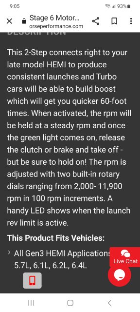

It's controlled by the brake pedal and the lowest stall is 2000 rpm. Didn't fit my needs.

One potential problem using it with the stock converter is the low limit I believe is 2000 rpm. I had one with the OE electronics and it worked fine but I had a 4000 stall converter with a T400. If you go with a Demon or aftermarket converter then it should be ok. Or you could try it and find out and let us know what happens.

The lowest setting is 1500, I have video proof of this. The 2krpm lowest setting is bad information.

They must of changed it since I inquired about it. I asked them if they could lower the rpm and switch it to a button control. They said no to both.

HHP also sold me the wrong burnbox before lol. All of that stuff they list is just copied and pasted from the supplier and not kept up to date

I know it says 2k rpm everywhere but line fuman said that could be wrong. If it goes down to 1500 rpm should be perfect

As I posted earlier, they told me that the lowest rpm was 2K.
