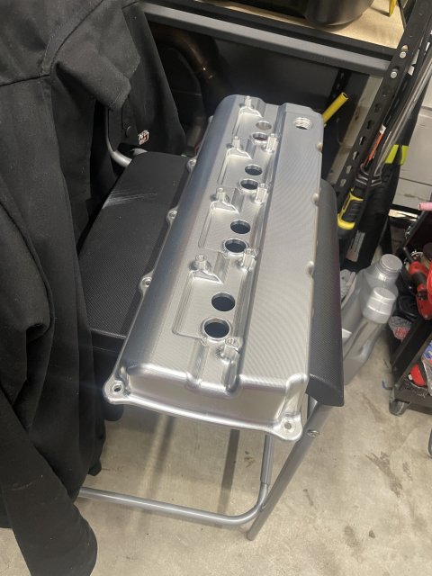

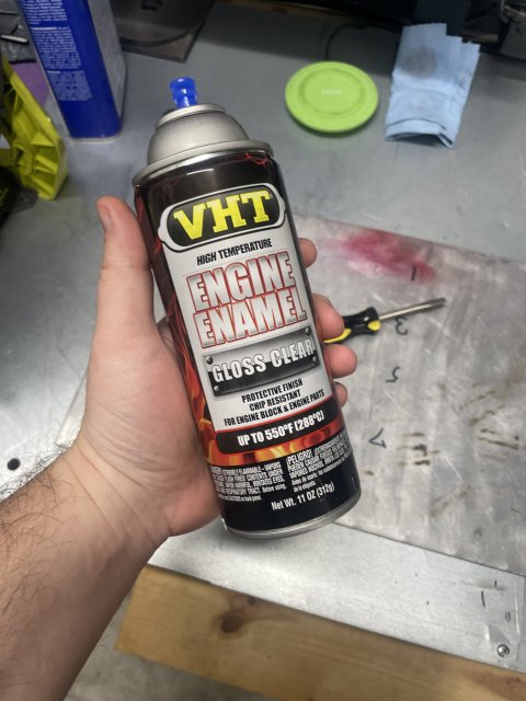

If they're unfinished Al you may consider a clear powder coat so they don't oxidize. Now would be the time to do it.

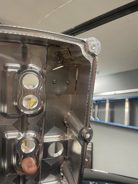

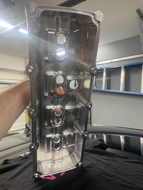

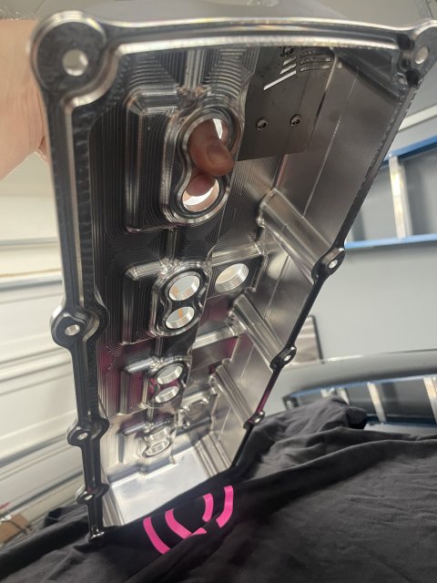

are those Manton? Can you show inside?
yes manton, i am in the process of clear coating them right now so i will post a pic when done.
1,455
3,677
very nice, thx.

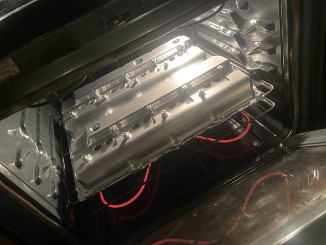

still have two hours before I can chuck em in the oven at 200F for an hour
